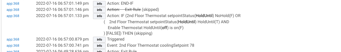

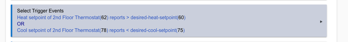

I have a trigger that looks at a thermostat heat or cool setpoint and compares each of them to a variable. This evening, I noticed when I increased the cooling setpoint, the action triggered despite the condition being false. I don't think it used to do this? I haven't done any testing to see if it is a comparison to a variable that's causing it to pass through or if it would do so with a fixed value.
I'd expect the above to only trigger if the cool setpoint was decreased below 75 or the heat setpoint was increased above 60.
You can see the event was the cool setpoint changed to 78 but the trigger fired anyway and the actions were evaluated.

No, it will trigger (and always has) on any event that matches the criteria. If you only want to trigger on a specific state change, required expressions make that easier to capture now. See: Rule-5.1 - Hubitat Documentation
Sure, but in this case the event was ā€œcooling setpoint changed to 78ā€. How does that match the criteria in my rule?
Wait, I was looking at the wrong setpoint. :slight_smile: Yes, that seems odd. What is the actual value of the variable (don't trust the display here)?
It is 75 —

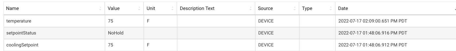

Please post the Event Subscriptions from the App Status page.
Sure, here you go.

If I reduce the trigger to just the cooling setpoint it works fine. I haven’t tried just heat but guess that works too. My theory is that somehow the two are conflated but I haven’t dug enough yet to know how/why. The events page for the device only shows cooling changed and I’d think it would show both if my theory was right (so maybe it’s wrong?).
The server response contains the heating and cooling setpoints so even though it’s only doing one of the two, both are actually updated. The events don’t show that because there’s no change to the heating one (in this case). I don’t quite understand why my rule shows the event as a cooling change but I suspect it’s the heating trigger that’s actually matched in this case.
