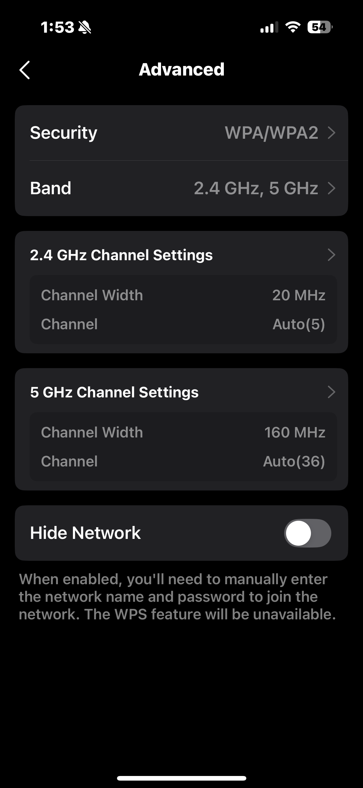

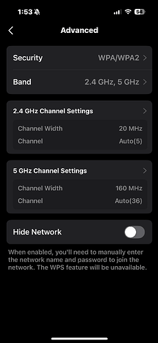

I just checked the Deco BE63 manual. Like other TP-Link Deco mesh systems, the end-user is not permitted to set the width of the 2.4 GHz channel or pick the channel. Also, the system defaults to 2.4 GHz channels that are 40 MHz wide.
So to go back to @ronv42's point, how do you have the channel width set to be 20 MHz? These Deco systems also "re-optimize" channel choice when the firmware is updated or when they are power-cycled. So how are you getting it to stick to Channel 10?
In general, Deco mesh systems are a PITA and do not play well with zigbee networks. I'd recommend swapping it out for something more reliable and configurable.
Hi there at least on mine there is a setting under WiFi advanced
Oh oh looks like they are grabbing all the 5 GHz space also. I never go over 80 MHz because of any noise will drop down the connection speed and not all the 5 GHz Wifi devices support 160. Heck I found that 10% of my 5 GHz devices only do 40 even though I allocated 80.
