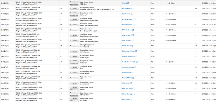

Devices have been sluggish over past few days - Topo is completely red and route seems direct for each device. What can i do to fix this and why did it happen? I'm on Zwave JS for a while and don't think that is the issue.
C8 Pro - 2.4.3.177

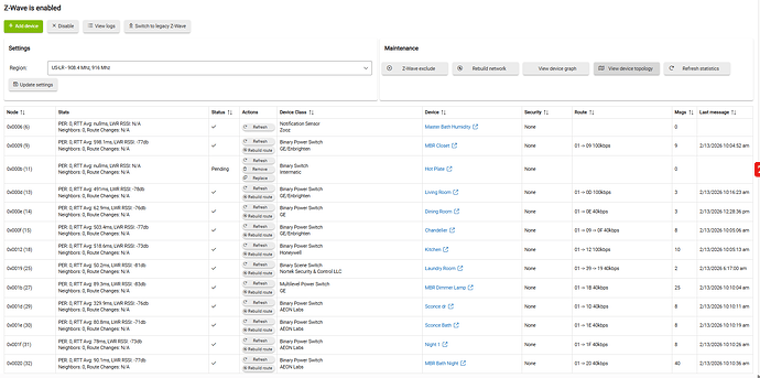

It's missing the node neighbor information for some reason.. This has no affect on the sluggishness..
If you run Rebuild Network it should re-populate the neighbors..
When was the last time you did a shut down and power cycle. Its the only way to full reboot the zwave radio. Sometimes it helps.
I would do that and then run the full rebuild (only once). Any nodes that fail you can run those again individually.

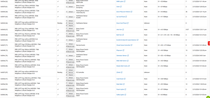

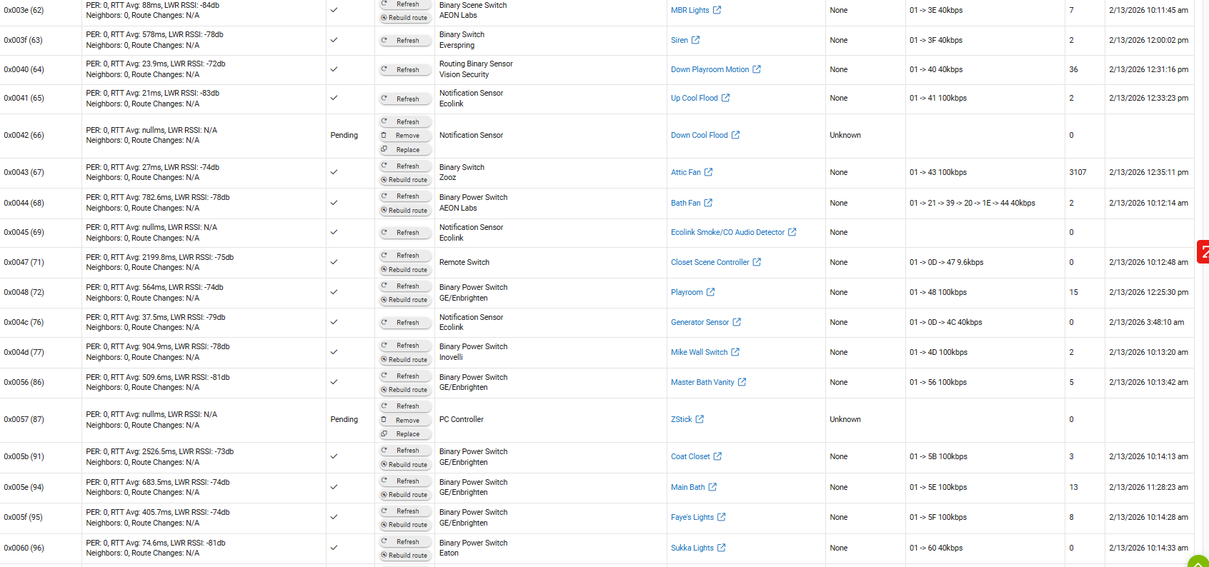

Is anyone else noticing the large number of devices in the Zwave details that have no route? Aren't those ghosts?
Not necessarily, they have hub devices attached. Could just have not populated the route yet, or could be unplugged / disabled devices that are offline.
