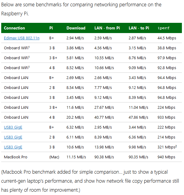

Maybe this is useful to my argument:
I just don’t see what any of that has to do with Hubitat’s LAN connection. Maybe I’m misunderstanding the hub’s IP network bandwidth needs but I don’t think so.
Sure we can save files to the hub now, but are you planning to use your hub as some kind of file server with multiple users simultaneously writing and reading files to/from the hub? It’s not a NAS device.
And I’m also not sure how Roku is related. That’s a device made for streaming video from the internet that naturally consumes much more bandwidth than what the hub does. A raspberry pi can do all kinds of things that might require more bandwidth too.

I'm afraid I still don't get your argument. Any automation system is going to be as slow as its slowest component. In this case, the slowest components are z-wave (9.6 to 100 kbit/sec) and zigbee (250 kbit/sec). They are slower than a 100 mbit LAN connection by several orders of magnitude!
