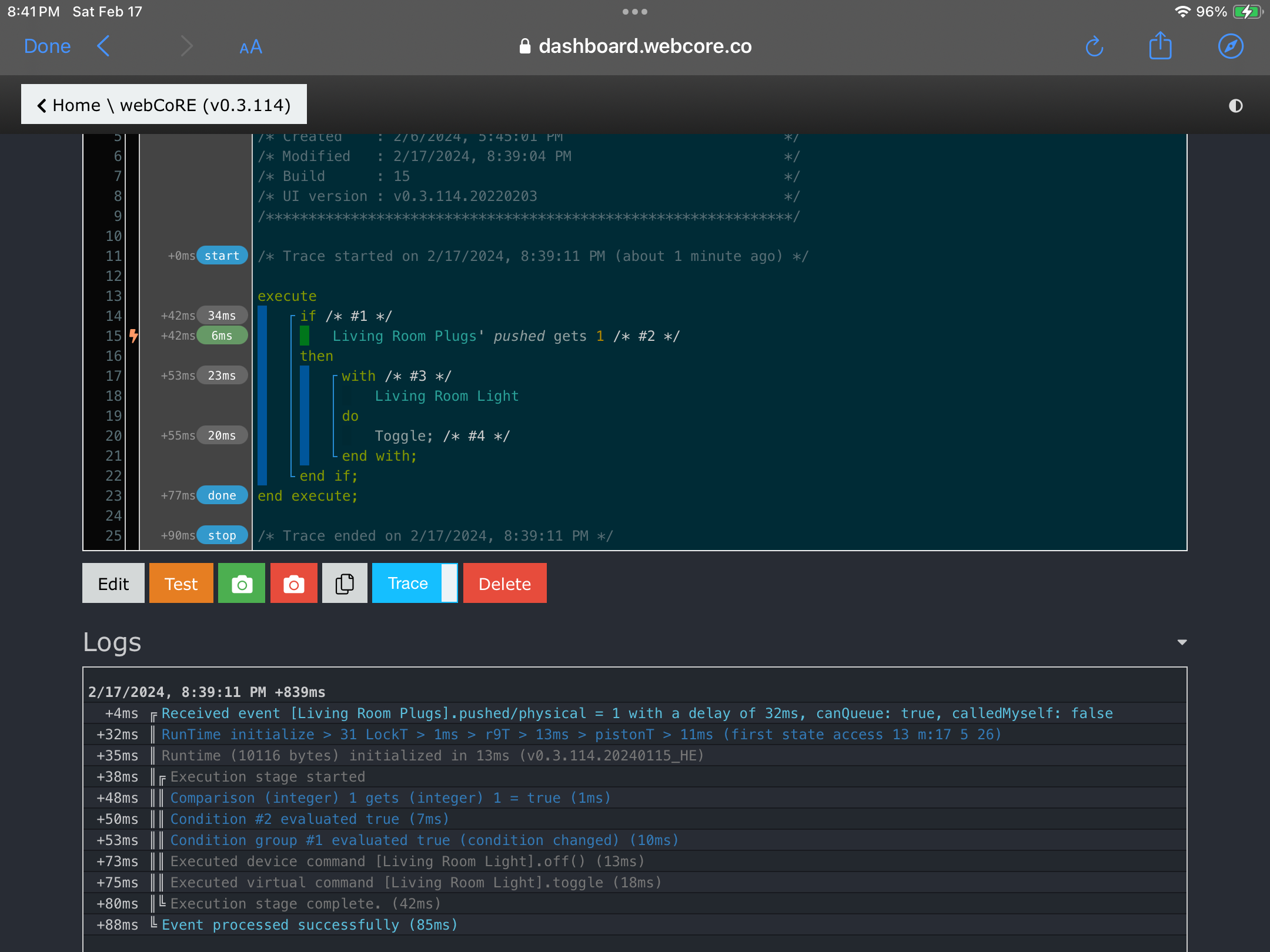

I have a button that I push once.
The statement executes,
The light comes on and immediately goes off.

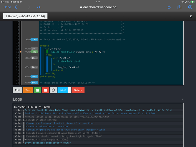

In the trace you'll see that there are 2 evaluations done and the toggle is done twice.
Why. What am I missing?
When I tried to do the same thing in a basic rule and the button app, the result is the same, the light comes on and immediately turns off.
I don't see where webCoRE is sending the command twice ("toggle" is not a real command but a "virtual" command, and "off" is the one it actually executed according to your logs--there is one entry for each from what I can see).

You can see in the trace where the piston sends a command to the device, then sends a virtual command to toggle causing the on/off to occur.

I would start by addressing the questions I posed above. I can't say anything more without more information since nothing looks odd from the webCoRE logs above alone.

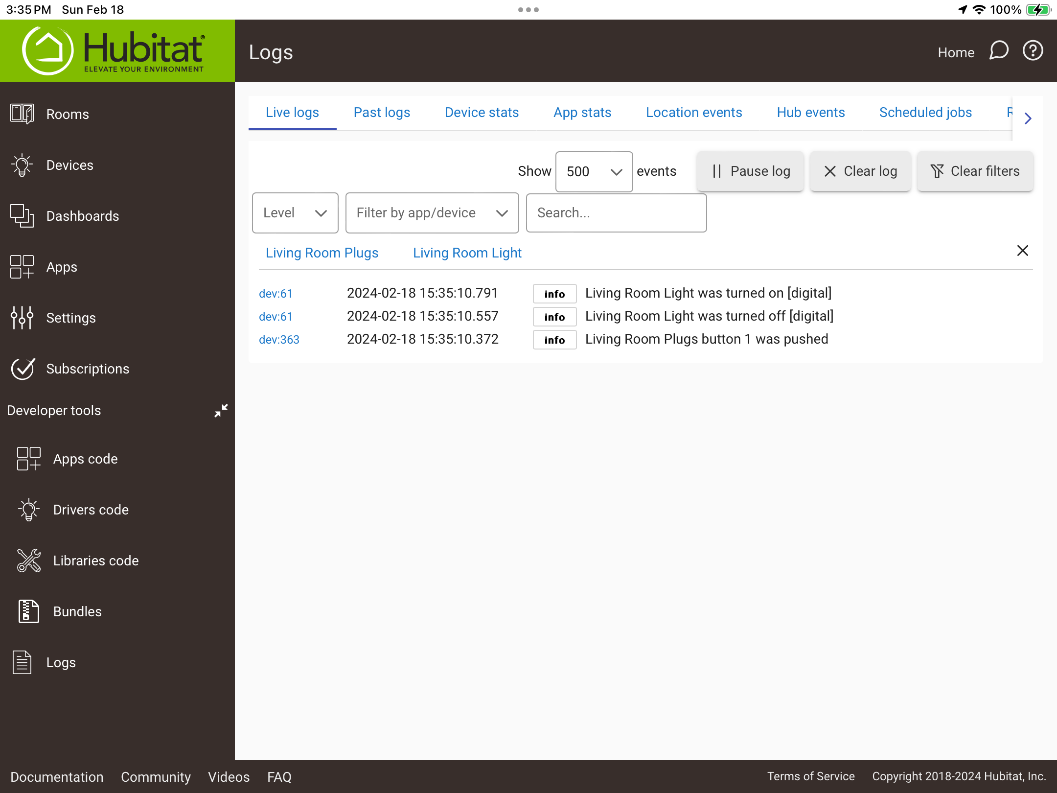

what these logs show is 1 command was sent to the device the off command. It was done by the virtual command toggle.
Your device logs would likely show what commands and by whom were sent to the device if you post those.
I don't see this piston doing it.

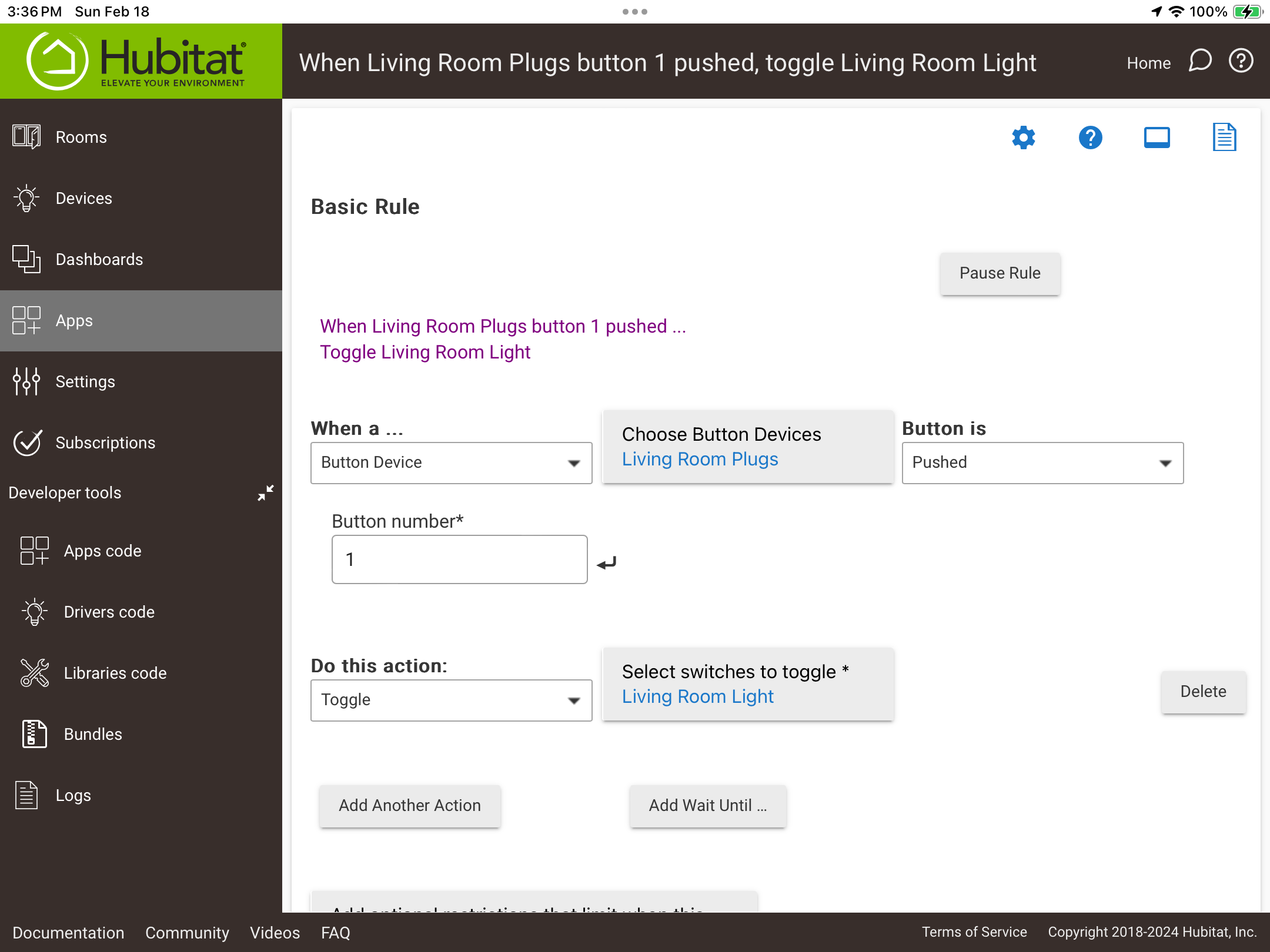

Ok, I simplified everything. I've removed the piston from WebCore and gone back to the rule machine.
Same result.

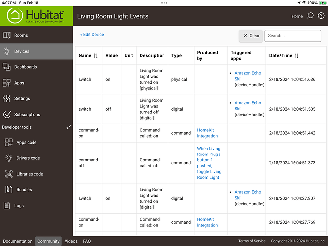

Click the "info" box in that Logs screenshot above to go to the device detail page for Living Room Light (or just go there yourself from Devices on the left). Then, click "Events" at the top.
In this table, look for entries named "command-off" and "command-on" around 15:30:10. In the "Produced by" column, what apps are listed for all such commands? (You may see multiple entries around this time; look at them all--but again, you are only interested in commands, not events--names that start with "command-" and have "command" in the "Type" column.)
Looks like you have an automation in Apple Home that is turning this device on. That is probably interfering with your desired outcome from Hubitat.
Check your "Automations" tab in the Home app, or temporarily disable the HomeKit integration, among other possible ways to eliminate this concern, to see if that helps.

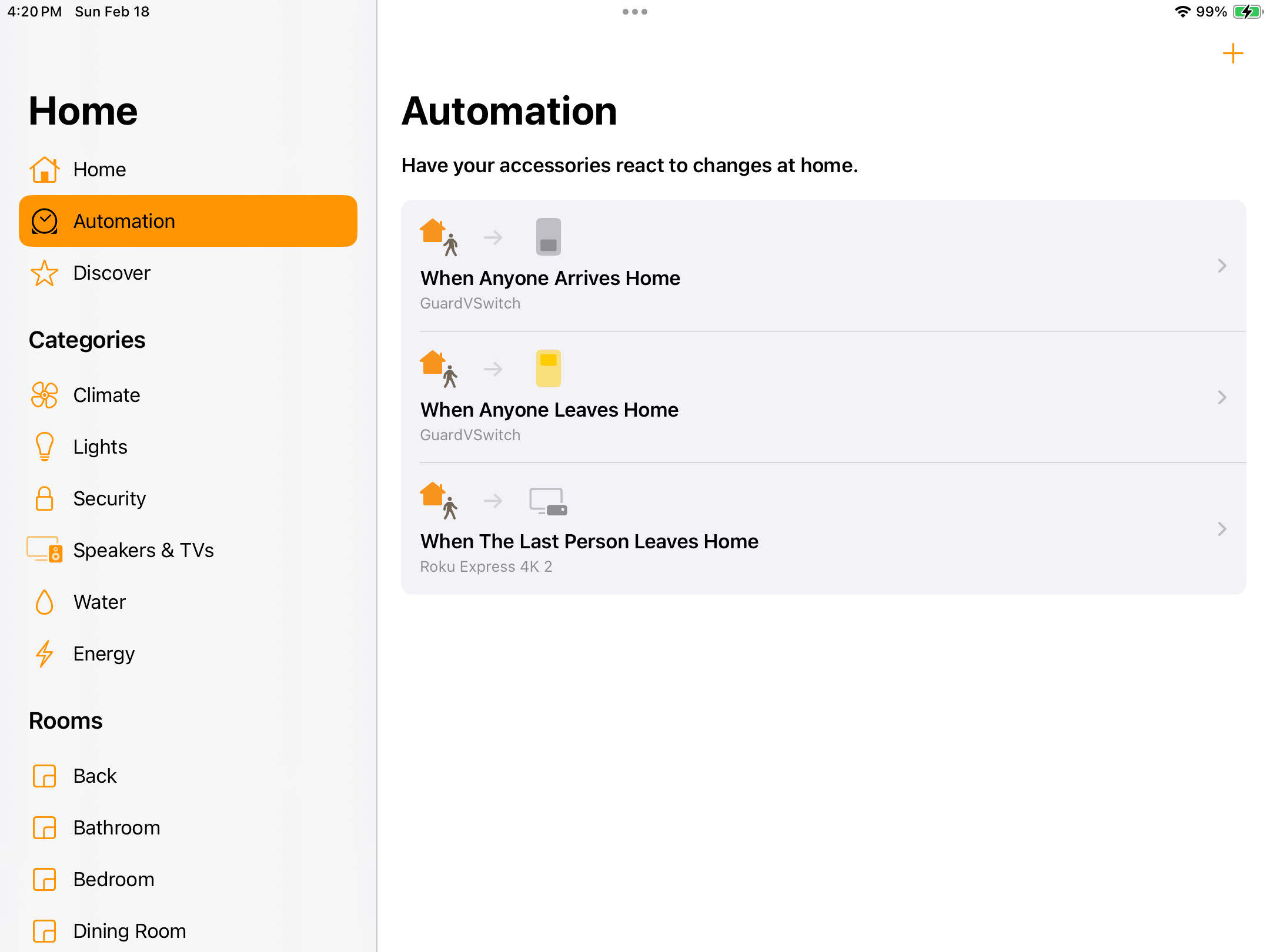

Only 3 automations and none with the living room light.
