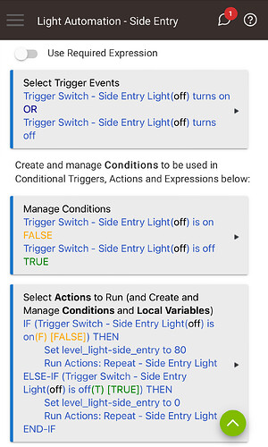

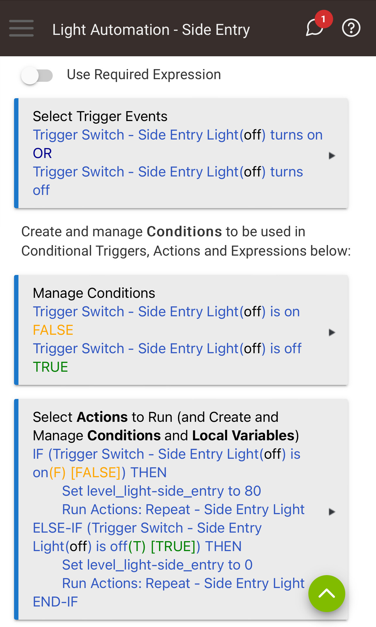

Here was the trigger code (I later found ways to use this as well with Room Lighting).

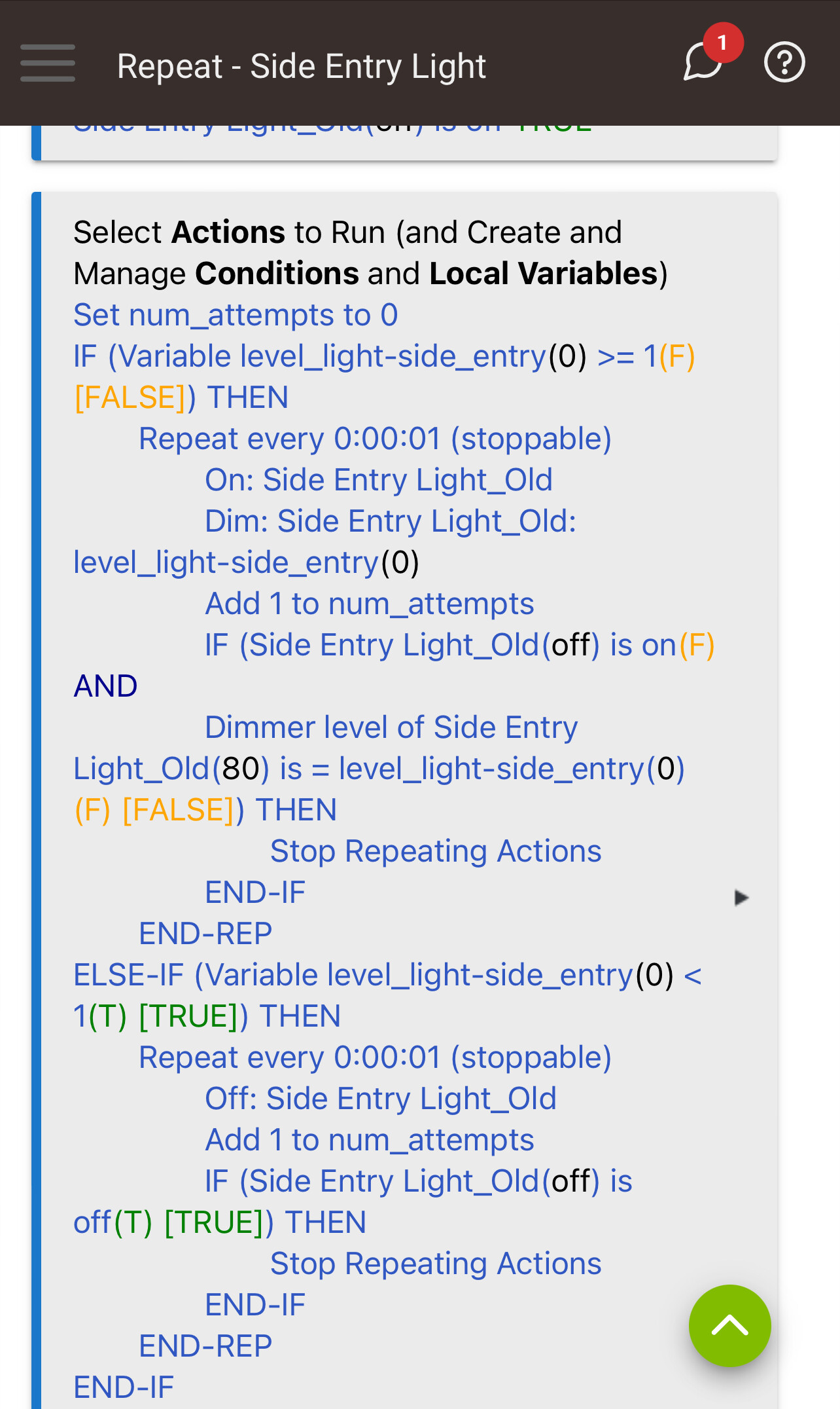

Here is the Repeat Loop code (there was no trigger so this was only called by other rules and apps).
I added the iterations count as I was curious how many times it would take to make the updates, rarely was it less than 4.
