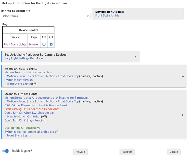

gerald1:
No motion would be nice.
I recommend using Room Lighting. You just set up the periods or modes to match your scenarios. Some modes will turn on (Activate column), all modes will turn off. The setup should be similar to the following (that shows within Day mode only turning on via switch, off is based on timer or motion ending):
Room Lighting can be complex, but gets easier with use.
