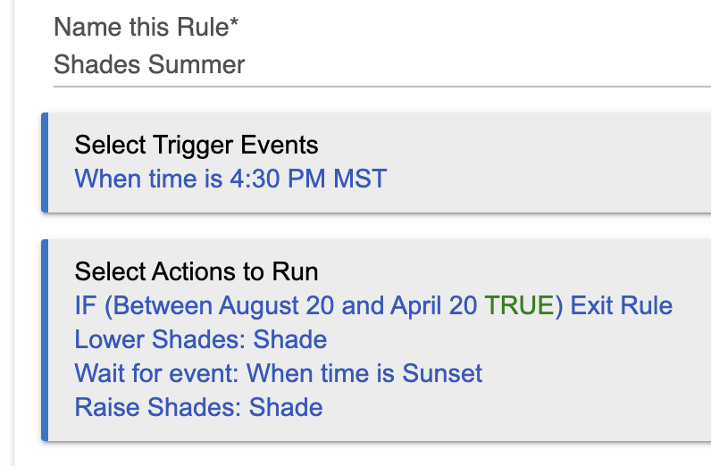

  3. It is also possible to test a condition of "between two dates", as well as "between two times". I have a rule that puts a certain shade down around sunset, but only between April and August.
