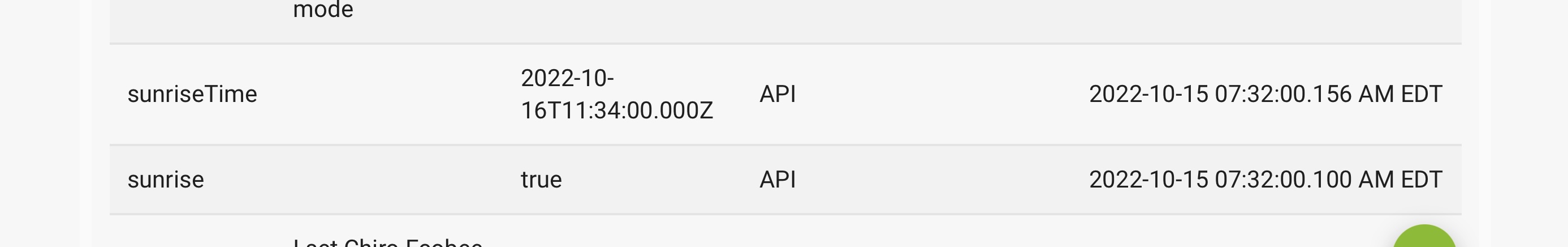

Recently I was told to turn on logging so I did. I completed this change during the day time (so the required expression was false). After I updated the rule it properly reflected this on the app list again as it should. I did not have time to look at it again until this morning when I again noticed the light turn on AFTER sunrise. I returned to the app list and it did NOT indicate the required expression was false. I chose to edit the rule, made no changes, and hit update. Immediately the red notice appeared on the app list. In the following log list the event at 2022-10-15 08:25:42.059 AM saying "Required expression now false" is NOT when it actually should have gone false but is when I edited the rule myself. The actual time of sunrise according to the rule itself when I am in edit mode was 7:32am. It seems as though one this required expression goes true it will stay that way forever until I hit edit again and it corrects itself. Again this is NOT how the rule previously behaved and I made no changes. Any ideas how I can fix this?

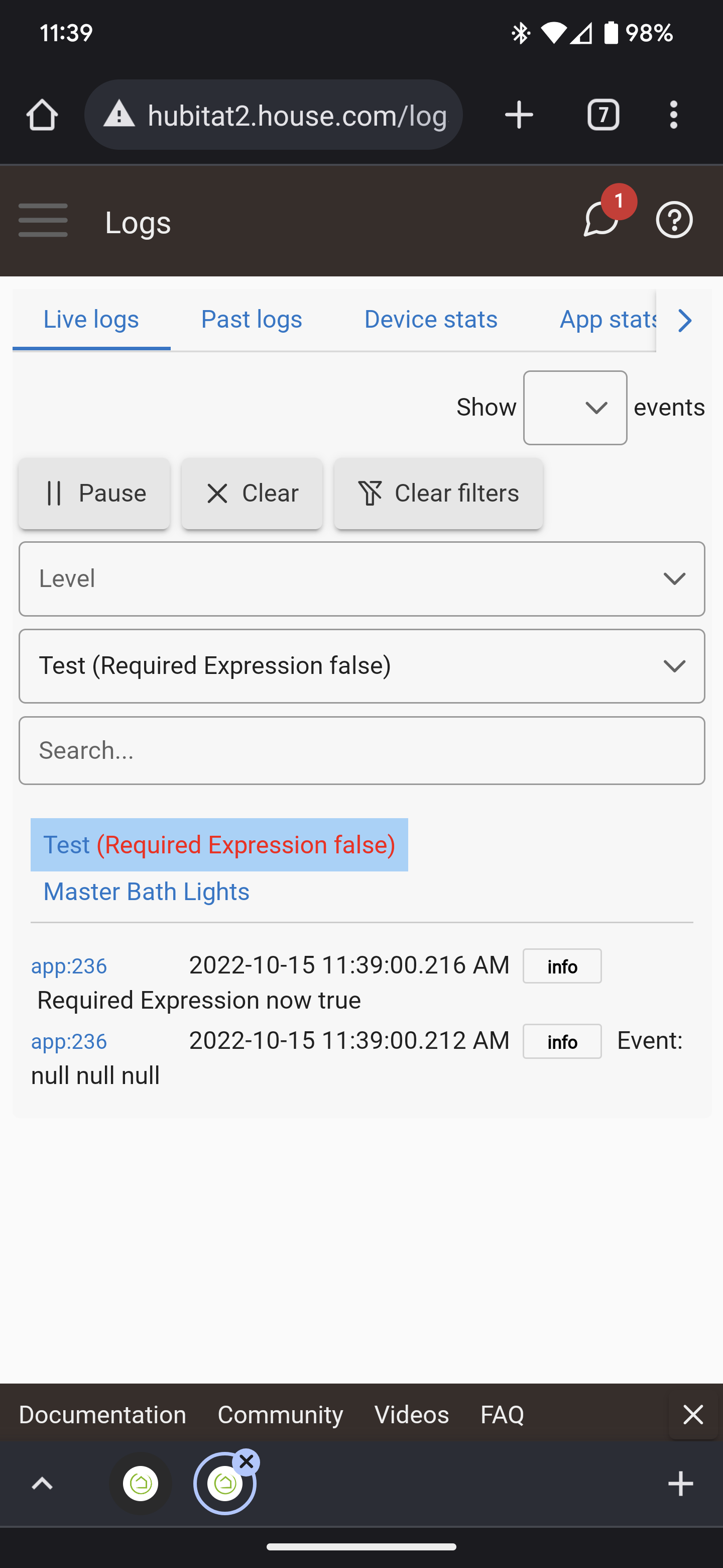

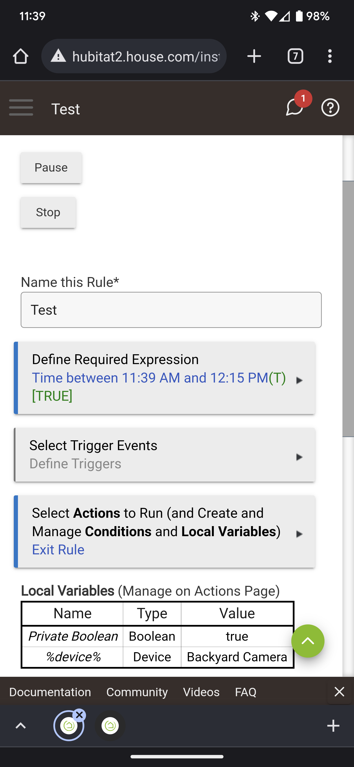

I can't reproduce this using specific times.
If you go to the Location Events tab from the logs page...is there an event for sunrise?

Yes I have that event in my logs.

Why wait until tomorrow? Clone the rule, change the Required Expression to a certain time (only needs to be for a few minutes), and check to see if it logs as true or false correctly. OK, this isn't 100% but it should give you an idea if the Req Exp is being honored.

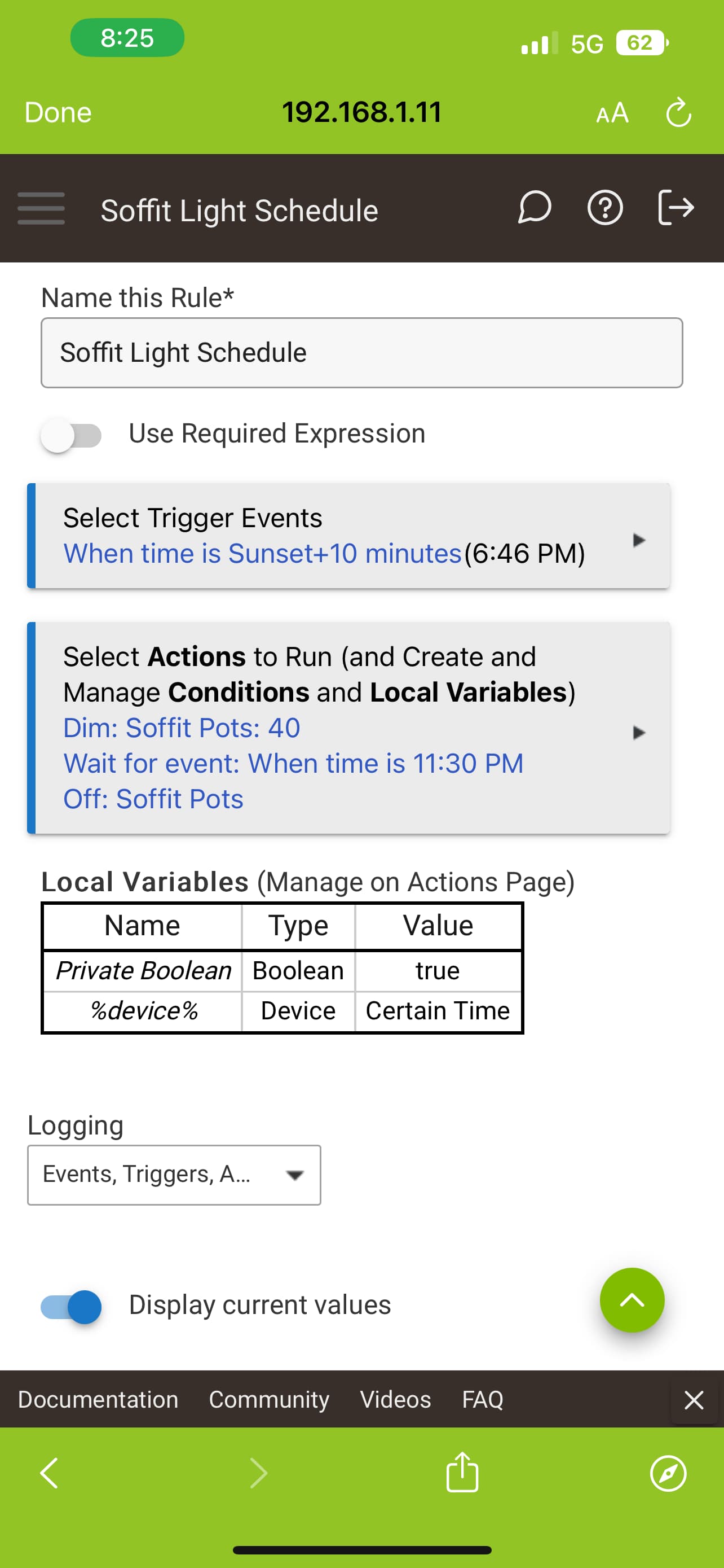

I have been away all day and unable to do any further testing unfortunately. However by coming home later than usual I have discovered yet another rule of mine has stopped functioning. Tonight is the first time I have realized it wasn’t working but perhaps it has been longer, I’d be willing to bet it’s been broken as long as my original posted rule.
I have a pot lights outside in our soffits. They come on 10 minutes after sunset. I just arrived home at 8:15pm to discover the lights never came on. Again it is a super basic rule based solely on sunset + 10. I am seeing a pattern that sunset/sunrise as part of a required expression seems to be a problem. As of yet I have no logs for this second issue as I just discovered it now and turned logging on right away.

Today however it has stopped working yet again. It is now triggering before the required time again. I returned home over 2 hours before sunset and the light turned on. It appears multiple "sunset" based triggers are not working as 2 separate ones triggered before sunset.
The first rule is the same one I have discussed in the entirety of this thread.
The second is a rule that is based on presence and time. If a member of the house returns home after sunset we have a light that turns on inside our primary door and a light outside that same door that turns on. They came on when I returned home well before sunset today.
