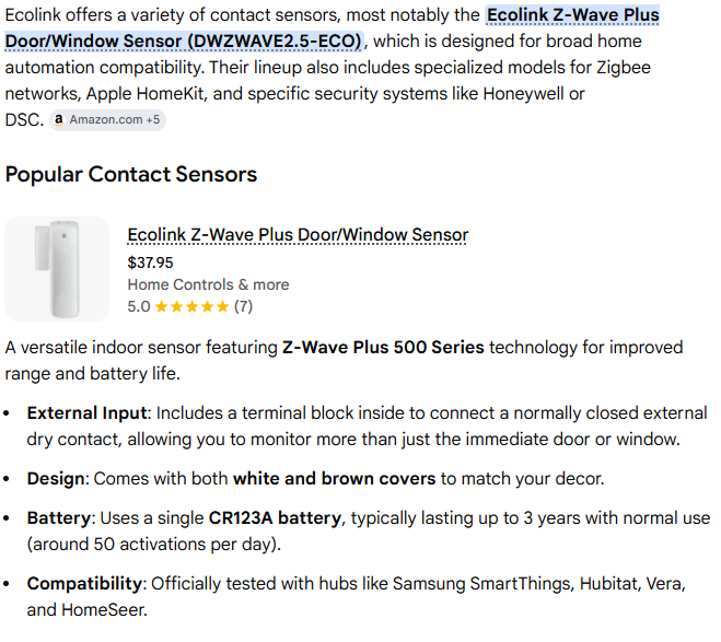

Just noticed t his one on Amazon:
That's the one (the thirdreality one above) I use on my garage doors. They work much better for me than the Zooz ZSE43 that are mounted right next to them (which miss reports/have wrong status rather frequently).
