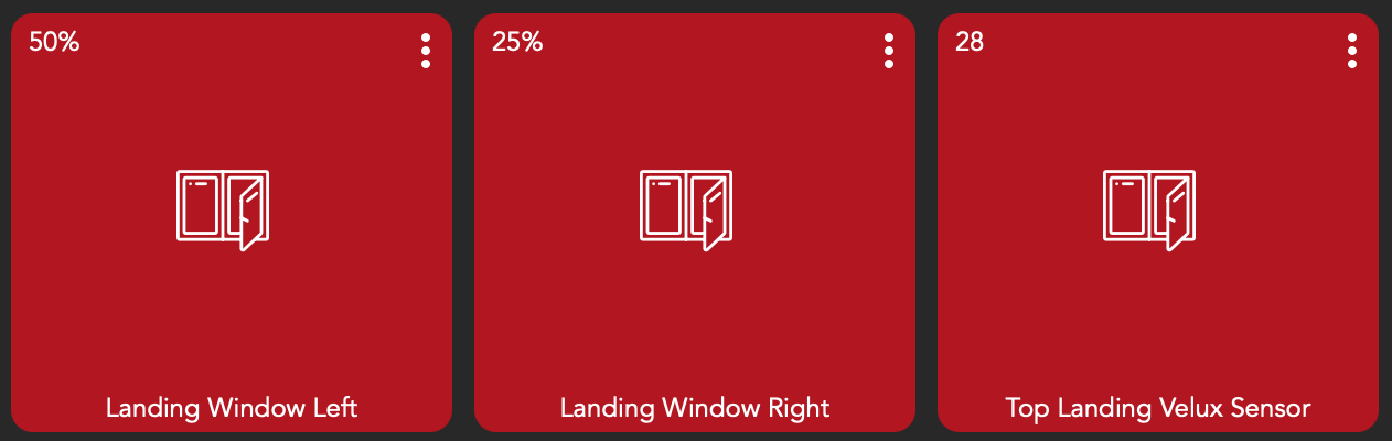

I have a weird situation where tiles related to the same Zooz ZSE41 Open/close sensors show the battery even with or without the percentage sign:
I have tried changing the Device Type to match the ones that show the % sign, but TBH the ones that show the % were created either with Generic Z-Wave Contact Sensor or the Zooz ZSE41 Open Close Sensor - some show the % and some don't.
When I look at the device setting, they all show the battery level as a number, so I have no idea why this is happening or how to fix this. Any ideas?
Thanks in advance.

It was the Device Firmware version that was causing the issue. I updated one of the troublesome devices this morning and it now shows the %.
