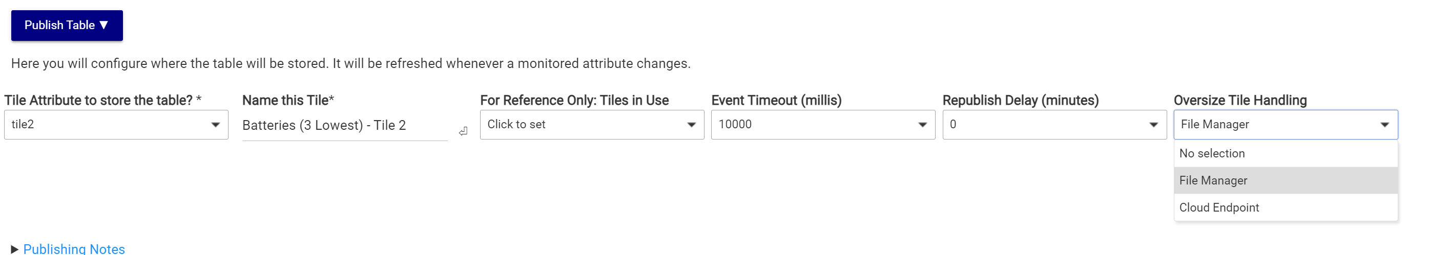

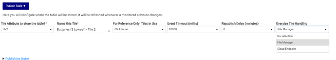

But I recently introduced the option of using cloud endpoints instead of files which should work in your scenario. You would need to enable OAuth in the Tile Builder Module application code and then change the default to use a cloud endpoint as shown below.
