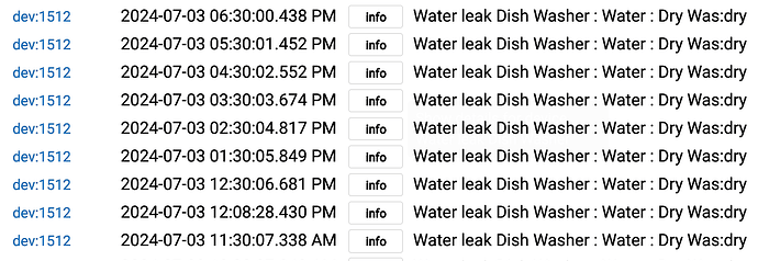

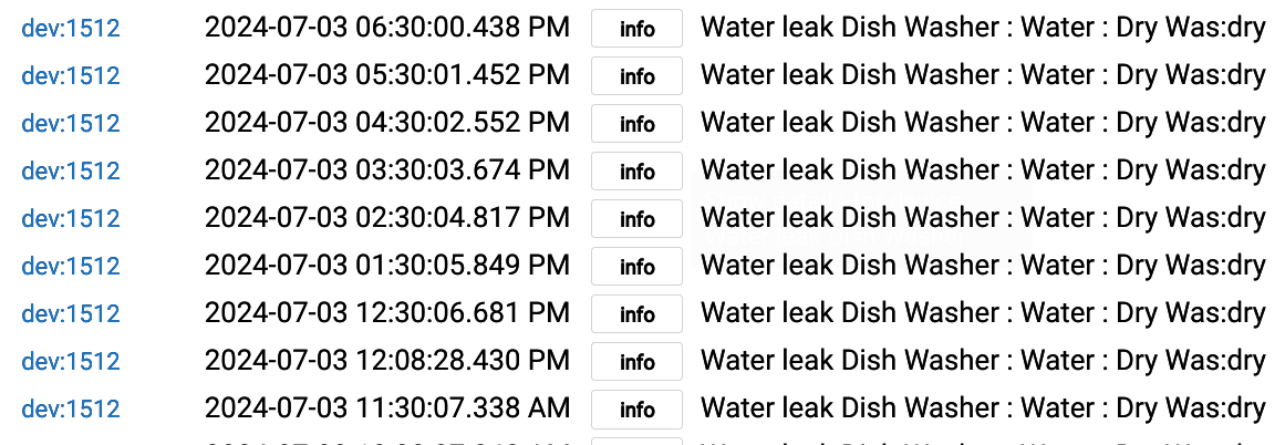

The Third Reality water leak sensors report every hour using the "Third Reality water sensor" tmaster community driver. They do not report battery but device activity check will report when they fail to check in.
