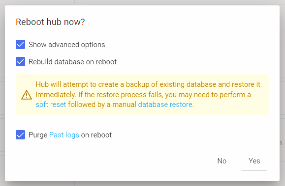

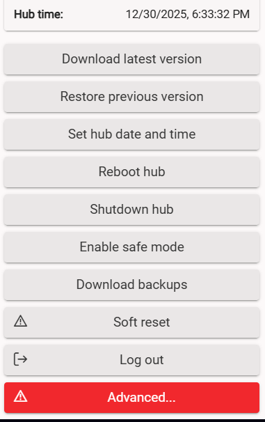

Have you tied to goto settings reboot ? check the options.
a soft reset ? Or the Hubitat Diagnostics Tool?
Will need a backup if you try this.,
What Happens During a Soft Reset?
  • Erases: Hub settings, device list, custom code, rules, and apps.
  • Keeps: Z-Wave and Zigbee radios paired (devices remain connected but unconfigured).
  • Why: It's ideal for troubleshooting a corrupted database without losing your mesh network, as you can restore a clean setup from a backup.
One other thing to do to gather data on this, would be to open a debug window in whatever browser you're using...not sure how to do it on Mac, on Windows/Chrome it's pressing F12. Then try to launch an app.
Aside from above, Warlock's suggestions are good ones...restart w/database rebuild first, then soft reset.
pretty sure don't need a reset .. I believe reboot with db backup does a reset and reloads the backed up DB in one step.
