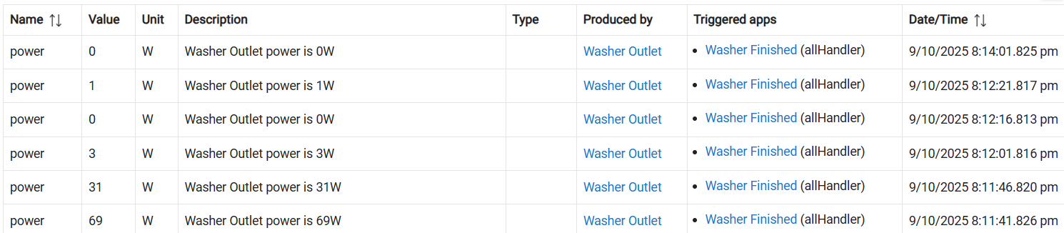

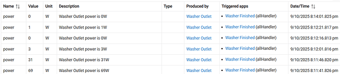

The screenshot below was taken at 6:52 PM. You can see that the last event was at 6:40 PM, 12 minutes prior. I have a rule that waits for the wattage to reach 0 for one minute, but it was not triggered. Looking at the logs it just reports the same wattage time and values.

You did not share any Logs. I don't see any duplicate reports by either time or value in your Events, however, which you did share, as seems to be implied. There is no indication of any problem from this alone.

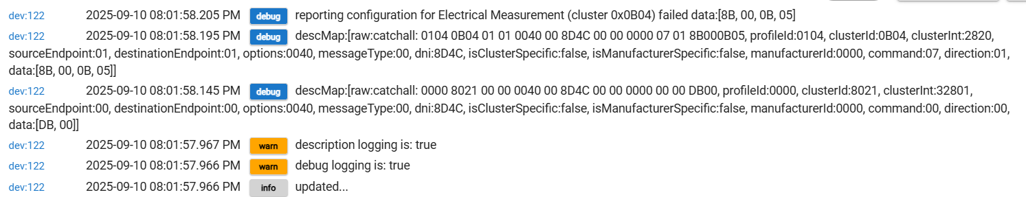

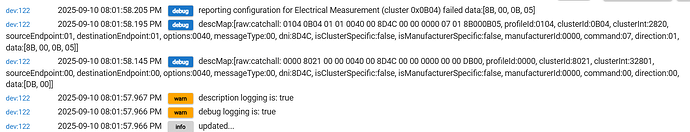

This issue has nothing to do with the washer notification rule functionality. It is now 8:00 PM and the events are still stuck at 6:40 PM. I did just turn on debug logging and you can see the electrical measurement failed error. I'll try running the washer again and see what happens...

The configuration log isn't necessarily an error, as there is another cluster that might be used for this, depending on the device. There are several different models by this brand, and I don't know what does what, but the fact that reports are working at all suggests at least one worked.
