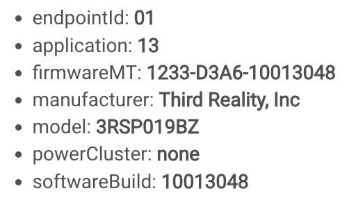

The firmware on one of them (10013001) seems out of date, not sure about the others as it's not indicated - newer firmware has been anecdotally "quieter" (expectations vary). I usually have description text logging off on those so I don't notice anymore.
You could try updating one plug to see if it improves the situation for you. To do this, hit the Update Firmware button on the device page. You can track progress on the logs page, under "Hub" (sys:1). Be warned it will cycle power to the load when doing so.

On the latest firmware, the behaviour I get on this model is two or three updates within a minute of a state change, then an update every hour. If this is not what you are seeing, then the Configure and/or reset and re-pair idea mentioned above is worth trying.
