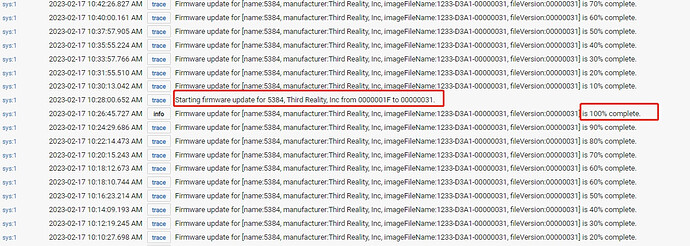

In our firmware, the file version is hexadecimal, like 1F.
But when OTA, in live logs, i see "update from 0000001F to 00000031". The current version of the device is 1F, and the next version is 31. But the two versions are the same. The decimal of 1F is 31.
Because of the different decimal display, OTA is still available.
So what I want to ask is how does the file version display when hubitat processes OTA? @mike.maxwell @bobbyD

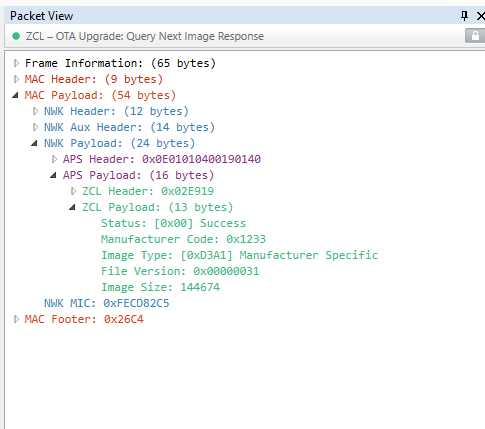

Some packet capturing information and logs are for reference
df1283008906082e2dbf705639d98f4
1994ab2b8e3a21e3be53d92f83a0242
e46d93ecf682c5ea34e422a2163483e
0x1F == 31 decimal, 0x31 == 49 decimal.
Since the previous firmware was tagged in the firmware header as 0x31 and the current version is 0x1F, 49 is bigger than 31 and 49 is currently cached on the local hub, that version is being used vs the intended version.
Currently there isn't a way to clear cached firmware updates.
We will look at adding this into a future release.
