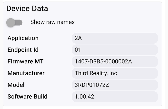

I’m not sure if mine is newer or older (or same)? What is software build?
Software Build 0000002A = 2x16 + 10 (A) = 42. It looks like you have the latest version already.

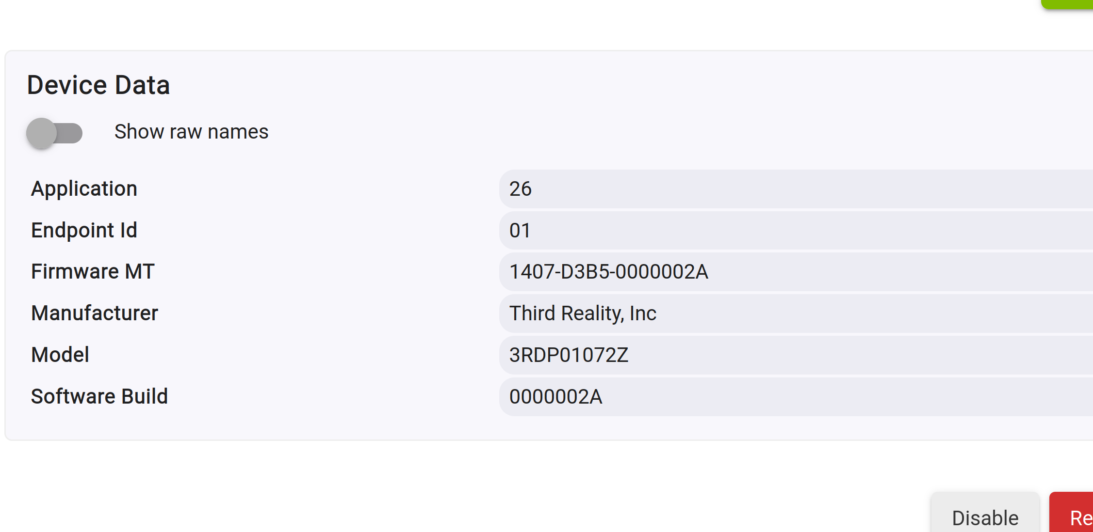

Mine
How you got the update ?
I don't remember updating it - it must have come with that version installed. @mike.maxwell what is the latest version served to HE for the dual plug?
The latest is 0000002A (dec 42)
I wrote back to the company asking for 2A, I’ll see. Thank’s for your answers.
2A is staged and online for a device initiated fetch

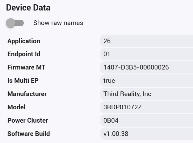

Also I don't see the image that you posted
It's software build: 1.00.38.
