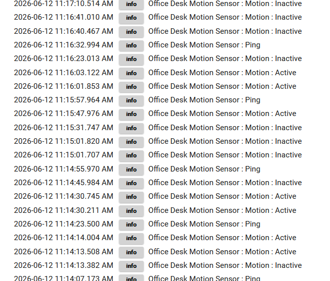

I have 8-10 Third Reality Motion Sensors. First, they work better than any other I’ve ever had. Until recently I used the driver Zigbee Generic Motion (No Temp). Recently after revamping all my Third Reality devices I located a more tuned driver that provided better more robust functionallity. That driver is from @tmaster I believe (based on its GNU and notes). I noted I was getting some errors after I switched over. These errors we basically race conditions and I’d find duplicate events in the log milli’s apart. Here’s a snippet of the devices’ log page:
I ran the driver through an AI check and it reported a duplicate event issue it located - I added the resultant code to my drivers after calling it ‘Custom’ and I’ve really knocked down the event logs! I’m sharing this information (not my customization!) to help others who may bump into this issue.

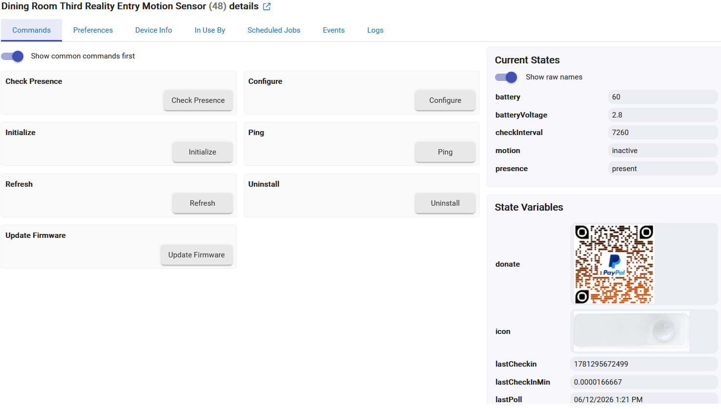

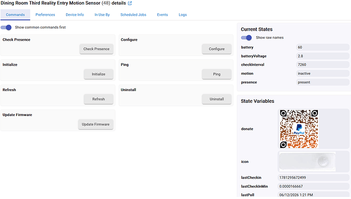

Some of the features (the donate and icons buttons were there originally and have not been touched):
