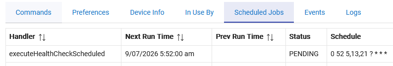

I really want my Schedulers for polling to be functional and bullet proof. I hate when I get red errors in my logs.

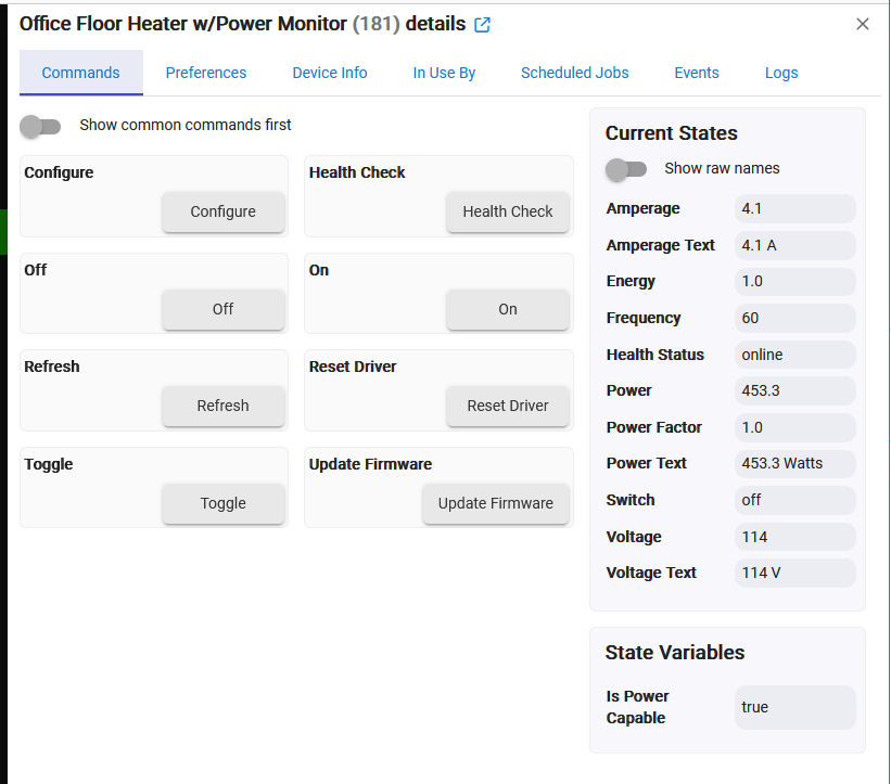

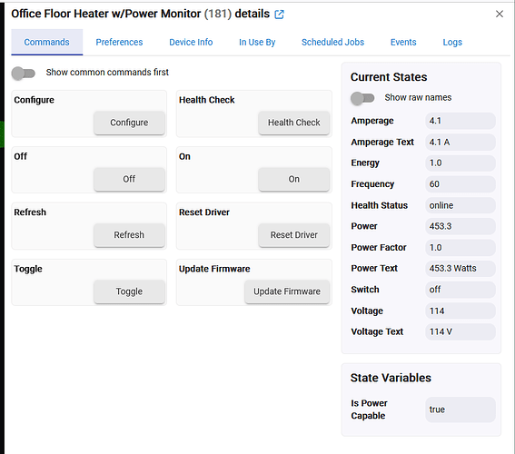

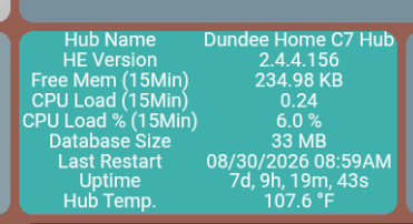

And I wanted Toggle. Some drivers have it, some don't. I like to hit toggle through apps (I'm weaning off rules and writing custom apps now) so it was a must have. Honestly, My hub performance used to be 16% for the 15Min load. Now it's 6.0%. I've cut the fat as they say.
And the Commands page:

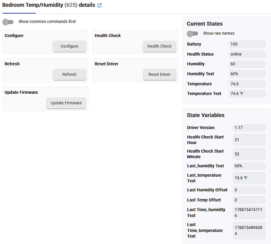

After I worked really hard on this, I moved on to the Motion Sensors, and that led me to do the contact sensors, and finally the Temp/Humidity. The api for the Third Reality is super well documented and the generic drivers work -but they don't always use the native methods, which I think are more robust. Turn on the Trace and Debug and watch my driver do its thing. I'ts really cool! I haven't work this long and hard on anything in a while - so I guess I'm will say I'm proud of the results. Are custom drivers better than generic? I think so, but I'm probably not a typical user!

This particular driver is very generic, but I did add Units for a text attribute so it can be easily added to dashboards and notification rules. It's brother, the LCD capable driver, is much more! it's actually a bi-directional driver that can change the display on the LCD - extended 3R commands you don't find generally in Tuya or Generic drivers. Oh - and the Reset Driver - I'm starting to love this - it was original just for dev work but I've grown to love it overall and am leaving it in nowadays.

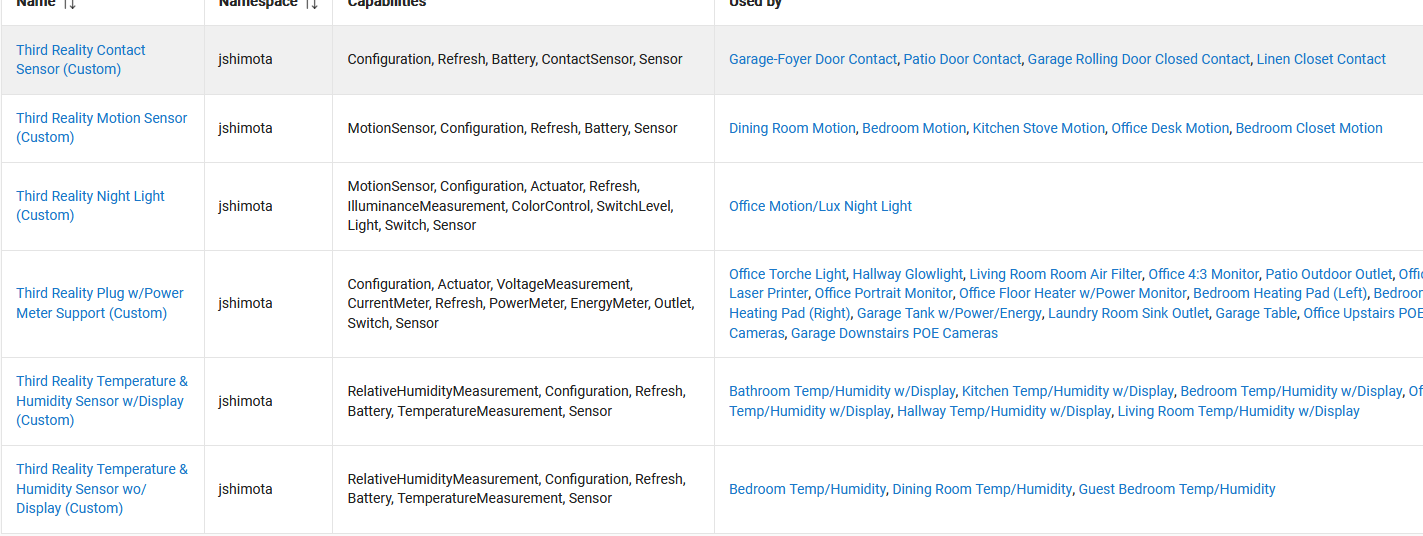

Released a minor update but want to verbalize it - HPM doesn't offer a new driver added to a package after you've already installed a package.
This is a bit hard to describe! I added the Third Reality RGBW bulb to the Third Reality Drivers (Custom) package. You will see an update available but it won't by default offer you the new RGBW bulb. You need to use Modify inside HPM, choose this package, then add your selection of the bulb.
The other 1/2 this update is optimizations to the Health Checks.
