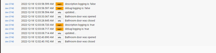

[edit]Just noticed your log says you are using the same driver. I turned on all the logging for the driver and opened and closed the door and only got two message open and closed.
I got it working by removing the device and resetting to factory and re-pairing it.
