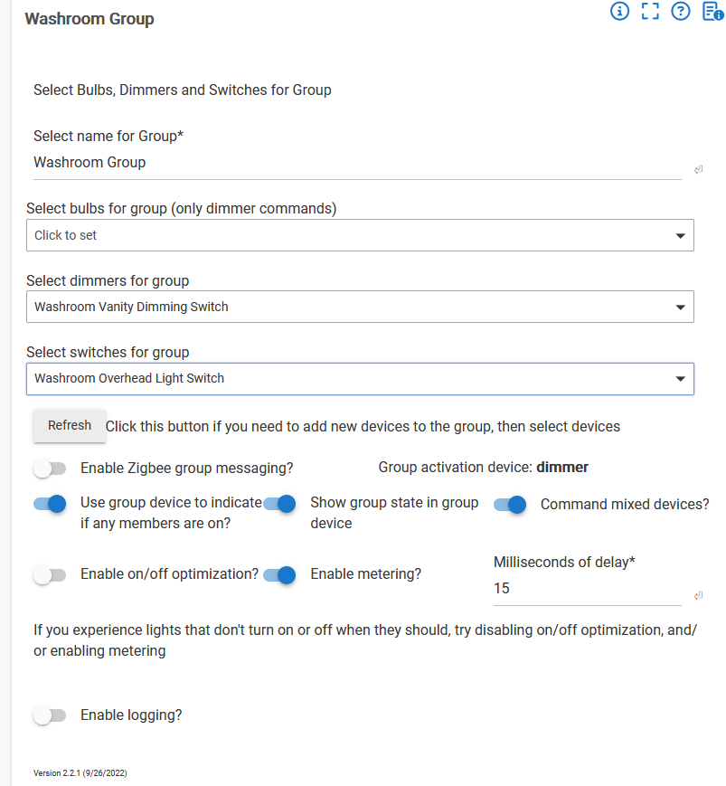

maybe try popcorning? I create groups as needed then add devices to the group. then at the bottom I set 'Enable Metering'. set a delay to the group so each device waits a tiny bit before the next device is commanded. This was a fairly old issue and hasn't been talked about much in a long while, but it still seems to solve a problem for me here and there. It can be applied to switches, to bulbs etc. I tend to not enable optimization. Alexa can respond that 'device is not responding' even when it does.

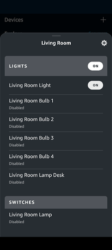

In Alexa do you have the lamps set up in rooms? If so is each individual bulb listed as a device along with the group listed as a device? If so try disabling the individual bulbs and only leave the groups for each lamp enabled. I had the same problem and this solved my issue. The enable and disable is in Alexa not Hubitat. Don't change Hubitat.

I am a bit lost with Hubitat terminology. Why would Enable Metering do anything? Another question: You show "Show group state in group device" turned on? What does that do?
Thanks in advance...
The docs have an explanation of both options:
So do I. However Alexa can/will put your groups you created in Hubitat in the same room in Alexa as your individual devices making up your Hubitat groups.
Below is a screenshot of my Alexa. The Living Room Light at the top is my Hubitat group. Then the individual bulbs below it is bulbs that make up that Hubitat group.
Notice I have my Hubitat Group "Living Room Light" enabled in my Living Group in Alexa and the individual bulbs disabled. When all them were enabled in Alexa in the same Alexa Living Room Group I had the exact same issue you are having.
sounds wierd but if you make 'Living Room Light' 'LivingRoomLight' it becomes unique to Alexa.
That is weird. I guess changing the name makes it unique. Never tried that.
