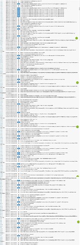

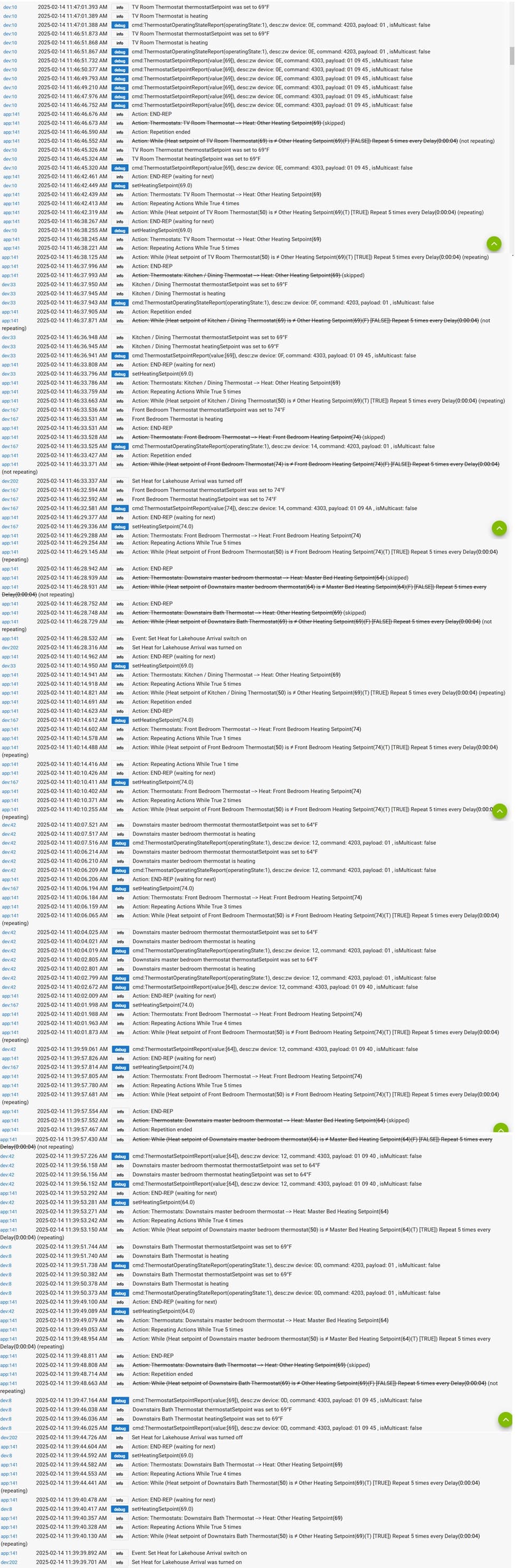

Below are screenshots of (1) my setup in Rule Machine and (2) logs for when I tried to run the rule earlier today.
#1 - My setup in rule machine is essentially to take each of the five thermostats (Downstairs Bath, Downstairs Master Bedroom, Front Bedroom, Kitchen/Dining, TV Room), and using a "repeat...while" loop for each thermostat, repeat the heating setpoint command every four seconds until the thermostat registers the change, up to five attempts (so i do not get an infinite loop if a device is dead).
#2 - If you review the logs, you can see I triggered the rule at 11:39 am. Two thermostats were successfully set--downstairs bath, and downstairs master bedroom. Then, it tried to send the heating setpoint commands to the "front bedroom" thermostat five times, but that one never "took." It then sent one command to the "Kitchen/Dining" thermostat but did not repeat it (and that one never "took" either). And it never sent any commands to the "TV Room" thermostat for some odd reason.
So I triggered the rule again at 11:46. The rule correctly skipped the two thermostats that had already been set (downstairs bath and downstairs master bedroom), and then proceeded to correctly iterate on the remaining thermostats--Front Bedroom, Kitchen/Dining, and TV Room.

//==========RULE SETUP=========//
//============LOGS=============//
This is sign of mesh network issues, that no rule smarts can overcome. It is not generally true that you can't command multiple thermostats at once, but that too is a sign of weak mesh.
You should not need these contortions to deal with thermostats. Check out Thermostat Scheduler as alternate method to control thermostats. But nothing will be reliable until the mesh is solid, and yours seems anything but. I'd say the complexity of this rule is distracting from that basic issue.
