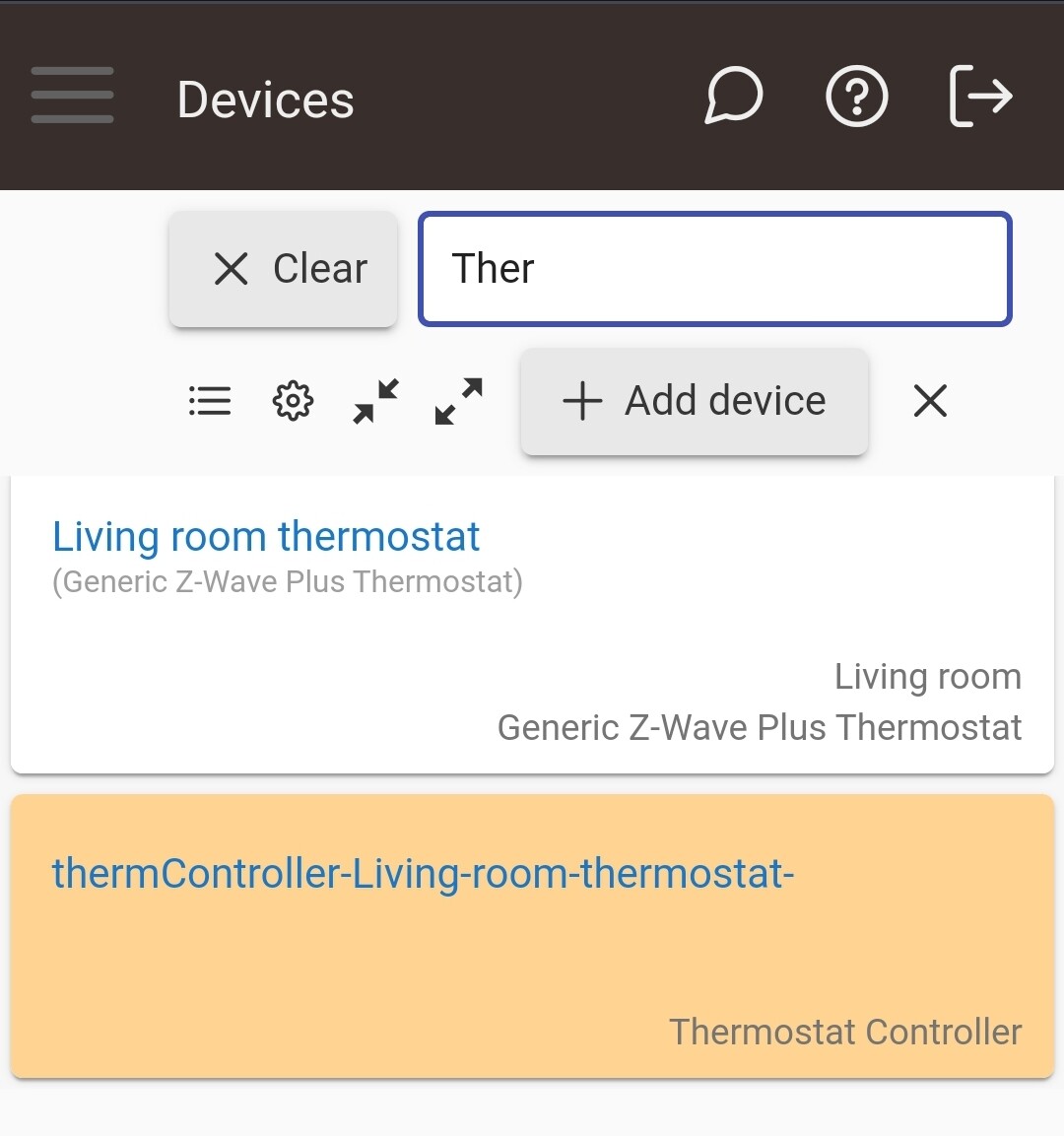

I must being doing something wrong, I can't get the hysteresis setting to work at all. Do I need to enable app events?
I didn't realize using the "Thermostat Controller" app, it creates a new device? I tried controlling the hysteresis setting from there and it still doesn't seem to do what I'm looking for.
I've never used Thermostat Controller, but the T6 does not use swing, it uses cycles per hour. You can set it within the thermostat config. The install manual gives some example values, but you can set it to your liking. (Not sure if it's touchable from the community driver or not.)
