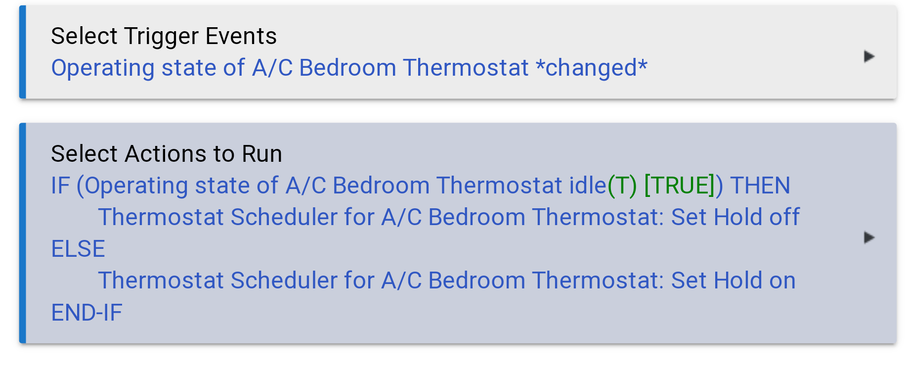

Here's what I did: I created a rule in RM that says, "if the state of tstat X changes then if it is idle take hold off of scheduler X, otherwise turn hold on."
This should take care of it, let it run-out it's current demand.

I'd like to revisit this briefly (I know, I know).
My RM rule works fine, but I'd like to target it a little better or alternatively I could write my own app for it.
This is what it currently looks like:
I'd like to turn that ELSE into something like this:
ELSE IF [current setpoint] < [upcoming scheduler setpoint]
That way it only sets HOLD on if the scheduler is about to make a setpoint change that would cause the thermostat to turn the equipment off (like I originally described up above).
The left hand side of that condition is easy, it's the right hand side that's difficult.
To do this the scheduler app would need to expose its schedule in a way that is usable by either RM or a custom app.
Is this currently possible? I couldn't find a way myself but I am usually either missing something or not looking in the right place, etc.
