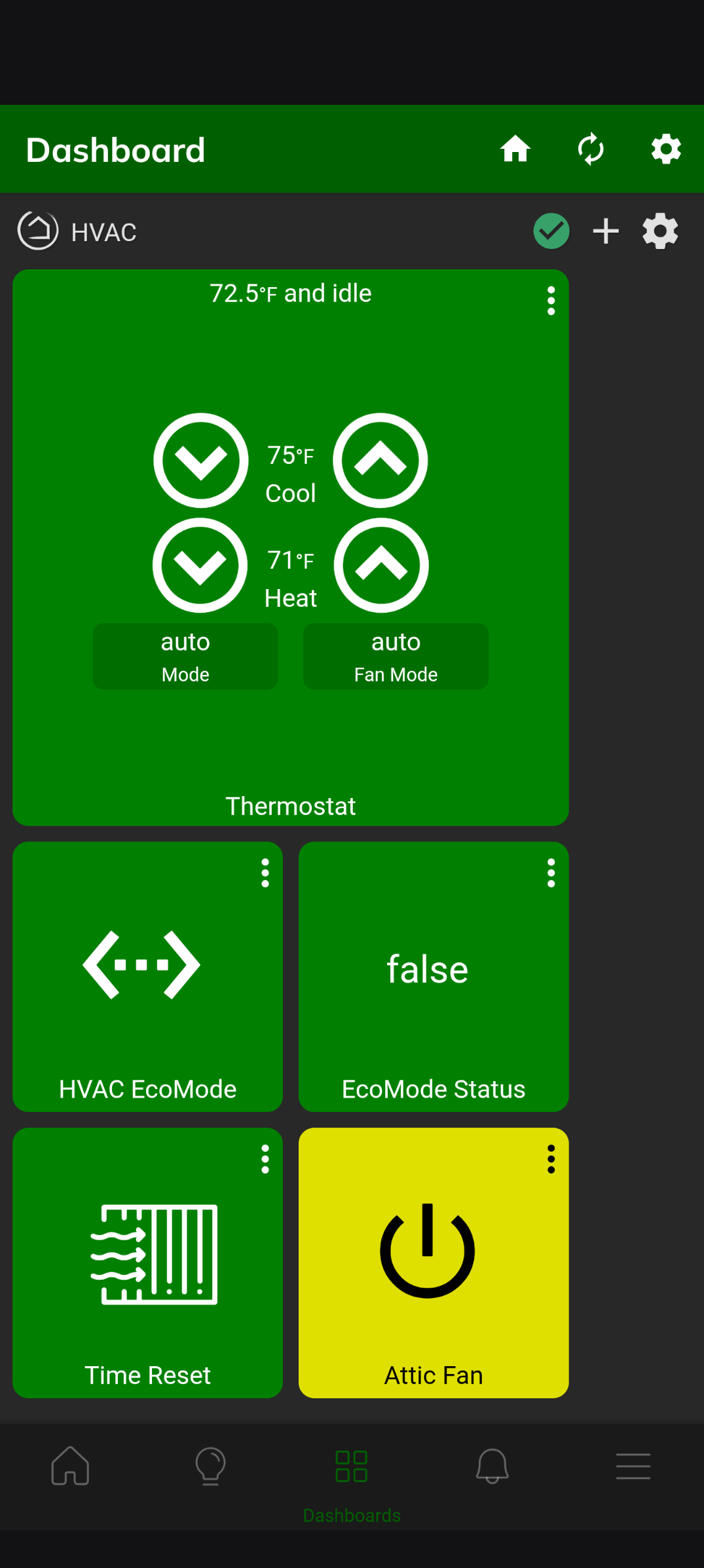

Use a thermostat dashboard tile for manual control. Your overrides will persist until the next set point scheduled change.

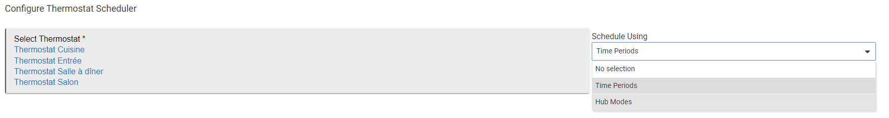

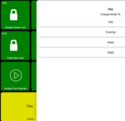

Instead of using timed setpoints what about using mode set points? Then if you get up or retire differently, you simply set hubitat mode and the thermostat follows along.
:point_up_2: :point_up_2: :point_up_2: YES This :point_up: :point_up: :point_up:
Modes is probably the best option and did not even know this was possible instead of time based!
Easy to Change Modes with a schedule or off schedule with a Dash Board Button.

Good idea. I don't think this is going to work. With mode you have no scheduled times. My house has many different heating zones all operating on different set point schedules. Each scheduler controls one or more radiators.
So I see you can have a variable for temperature setpoints. So for each schedule I define a new variable for setting the setpoint then drive the scheduler again. For making it cooler I just subtract some value and making it warmer I add some value. I know this works. I can't think of anything better at the moment.
Set mode change times or conditions over in Settings -> Modes (manage hub modes)
If you change the set points with a variable at some random time, part of that should be to push those changes out to the thermostat with set scheduled temperatures which is exposed in rule machine.
