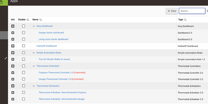

Here are the pictures.

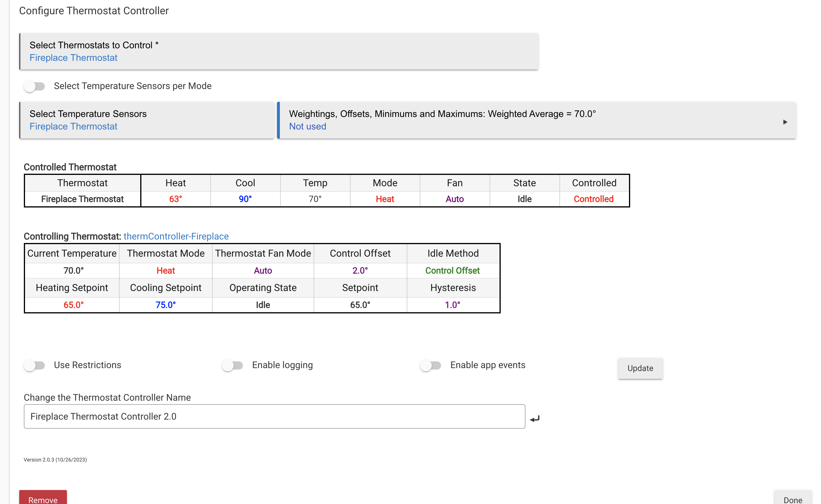

Is this possibly because of the offset you set? Thermostat Controller | Hubitat Documentation
I don't use this app so I am familiar with all the settings, but to me this sounds like this is what is going on.
If a temperature sensor's readings are out of balance with the other temperature sensors used or you prefer to weigh sensor values differently, it may be necessary to enter a Temperature Offset value, or adjust the Weighting to place more or less weight toward the average for each sensor. A Minimum Value or Maximum Value can also be entered for each sensor, which will use the specified minimum or maximum value instead of the actual sensor reading if the sensor ever reports a value below or above the specified value.
