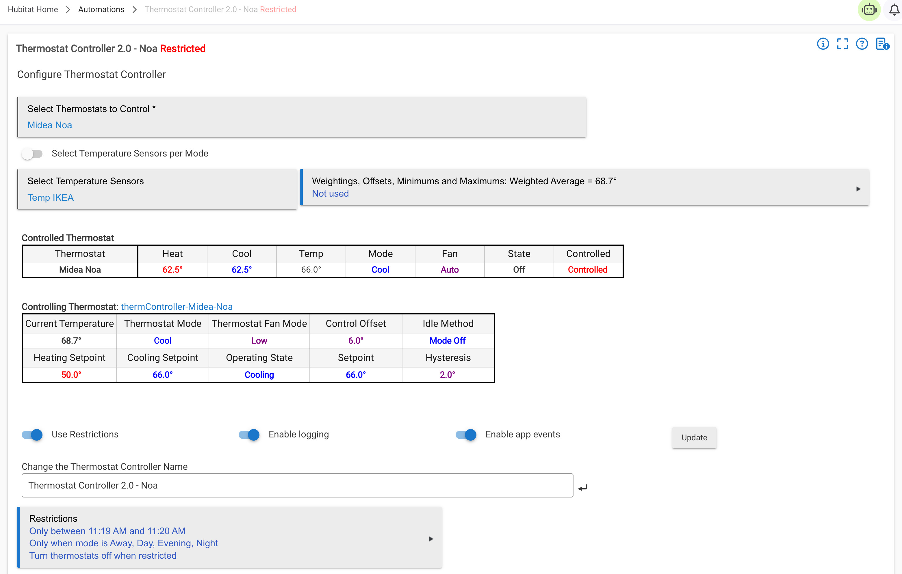

Hi, continuing this thread from years ago, since I added a Midea U-shaped to the house and really want to figure this out. Any ideas how to get Thermostat Controller to turn the A/C on?

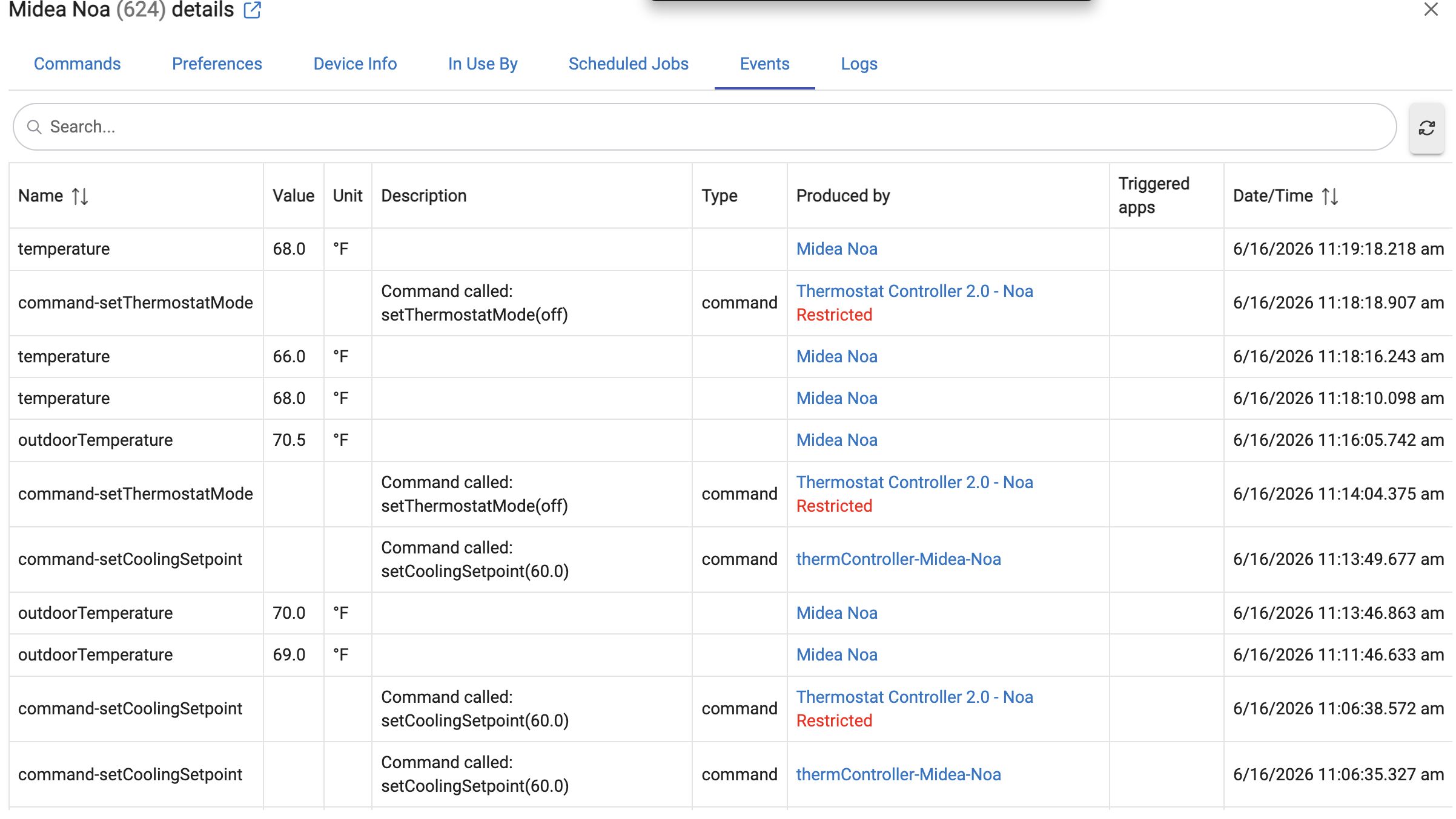

I expect to see command-setThermostatMode(“cool”) when the Controller isn’t time-restricted, but I don’t. I only see “off” when the time restriction kicks in. What logs would be helpful to investigate further?

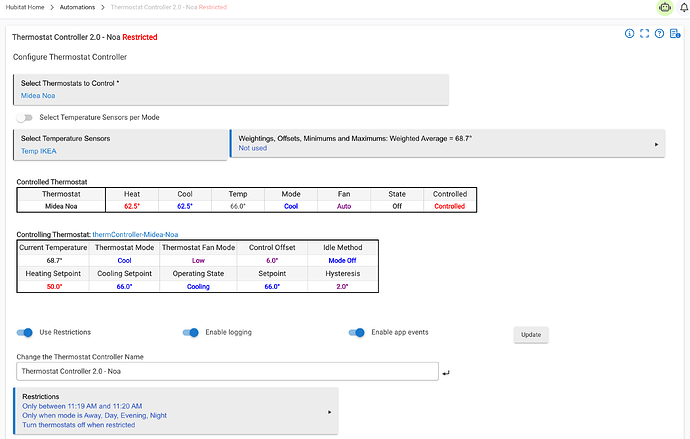

I realize I probably didn’t send nearly enough info. Here’s the Controller app setup at least:
