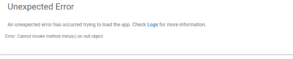

In .129 I'm still getting
java.lang.NullPointerException: Cannot invoke method minus() on null object on line 39 (mainPage)

I get these same errors on 129.

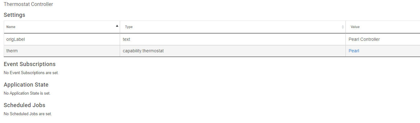

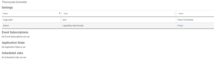

Installed the update, reinstalled everything, still getting an error. Setpoints will not update. I am using Hub Mesh on the controller hub. 1) Thermostat Physical 2) Thermostat Controller.
java.lang.NullPointerException: Cannot invoke method contains() on null object on line 571 (thermHandler)

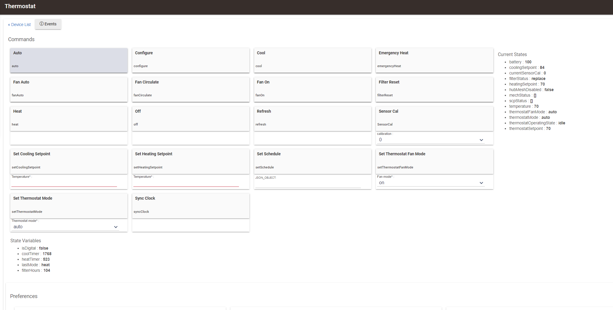

Show the device page for the thermostat in question, on both the real thermostat and on the Hub Mesh device.
What driver are you using?

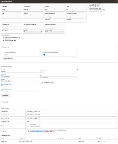

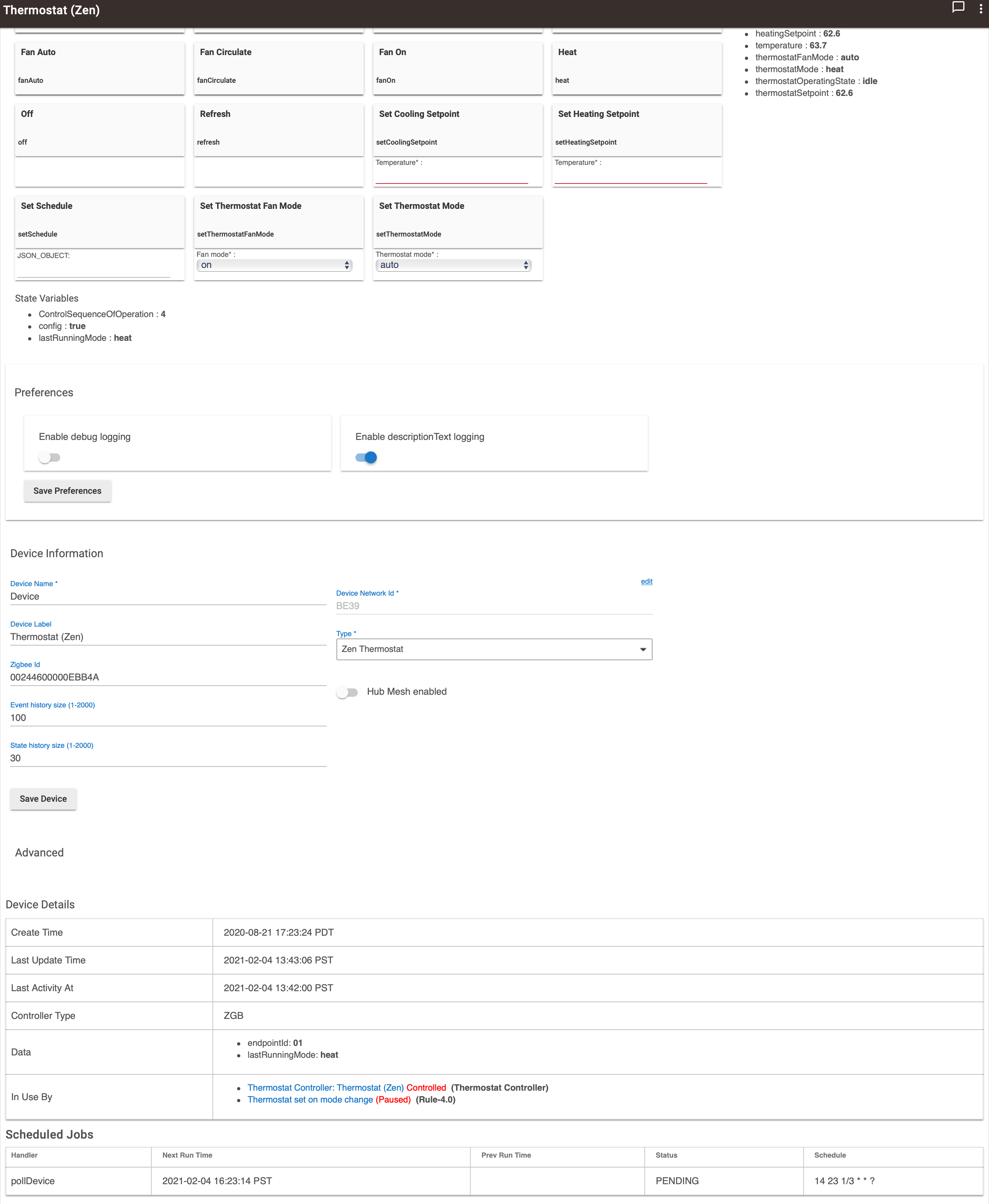

I'm also still getting the same error with .130. Zen thermostat. No hub mesh. I see "14 23 1/3 * * ?" down in the scheduled jobs, so I tried deleting the scheduler but still getting error.

I guess I should have checked my logs before commenting that I was good...setting it up went fine and error free and my first test seemed to work, now it is getting cold again and I have these errors.
The problem stems from this driver not having the attribute "supportedThermostatModes". That's what Thermostat Controller is looking for, and not finding it, blowing the error. So one fix is to add that to the driver, adding the attribute definition and in its updated method:
	attribute "supportedThermostatModes", "JSON_OBJECT"
  sendEvent(name: "supportedThermostatModes", value: ["heat", "cool", "auto", "off"])
Or whatever modes it supports in that list of modes.
The app isn't going to work correctly without that attribute being set.
