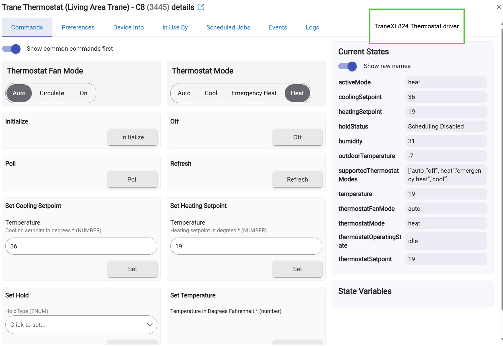

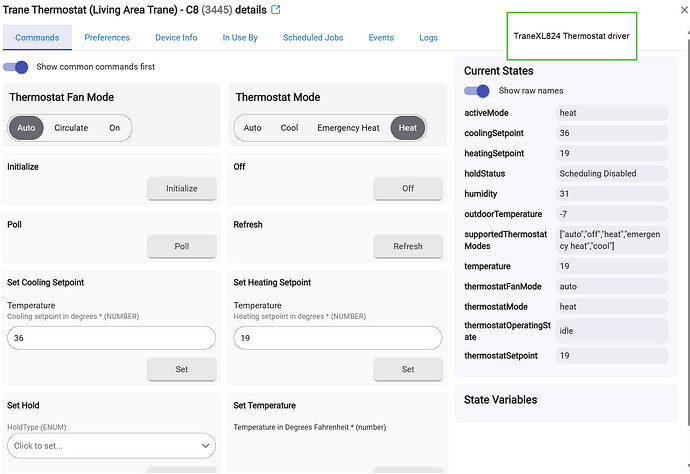

Here is a capture of the Nexia / Trane XL824 t-stat driver from HPM.

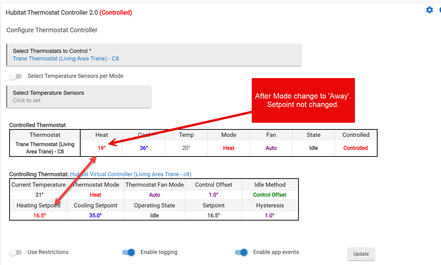

For my testing I have simply forced a change in the Mode from Day to Away. I am purposely using setpoints with a large variance thinking the offsets are not coming into play.

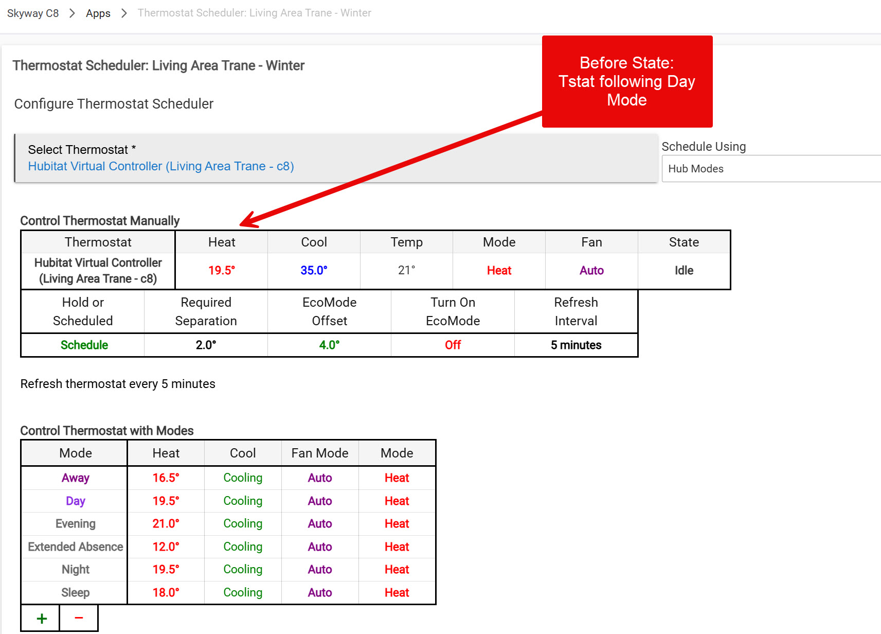

The Scheduler panel looks like this:

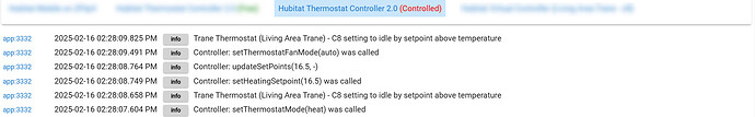

After the Mode change, the logs show the Scheduler acting as expected:

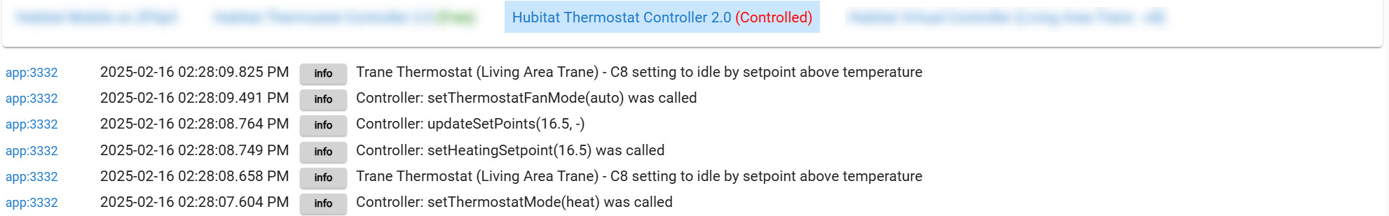

although the Controlled t-stat is not updating:
and it's log:

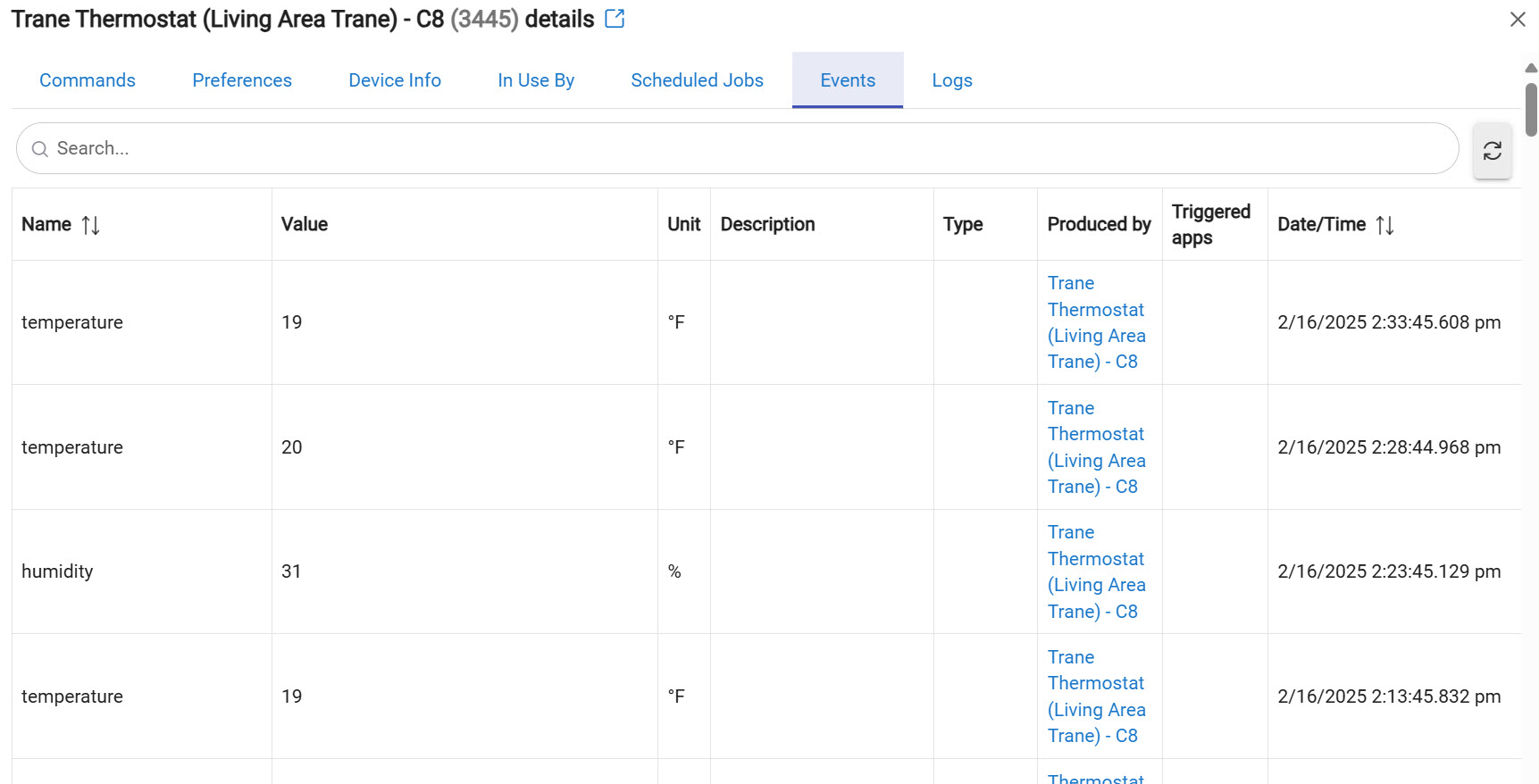

also the controlled t-stat has no Events of interest:
I don't believe the Nexia/Trane driver is at fault, since I note that if I have the Thermostat Schedule bypass the Thermostat Controller virtual controller the setpoints are passed through to the T-stat and acted upon successfully. The documentation advises against doing this but that is my way around the issue in the short term.
