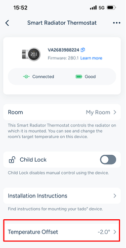

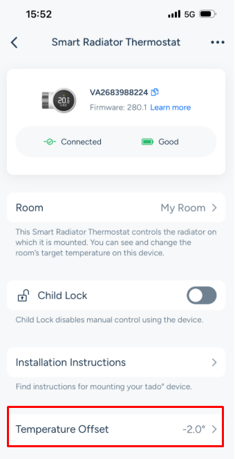

Have you already tried a very simple solution — setting a negative temperature offset in the Tado app?
Yeah, I can just set the header temperature offset, or a higher temperature on the TRVs. But it defeats the point of having Hubitat as the central point of home environment control. I bought it with the idea of not having to register into a dozen online services and having a dozen mobile apps, one for each aspect of my home.
