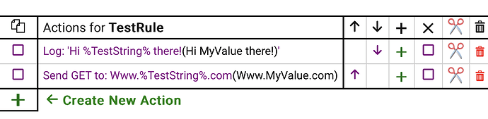

I'm familiar with them, in rules. But can you use it in the middle of a string? And throughout Hubitat? And if so how? Ie, http://%VARIABLENAME%/blah/blah.jpg or something like that?
I think so,see example.
Sweet. I should have just tried it instead of posting about it. Trying now. :slight_smile:
[EDIT]
It works in RM rules with my http GET's, but not to include images on the dashboard. Better than nothing I guess.
