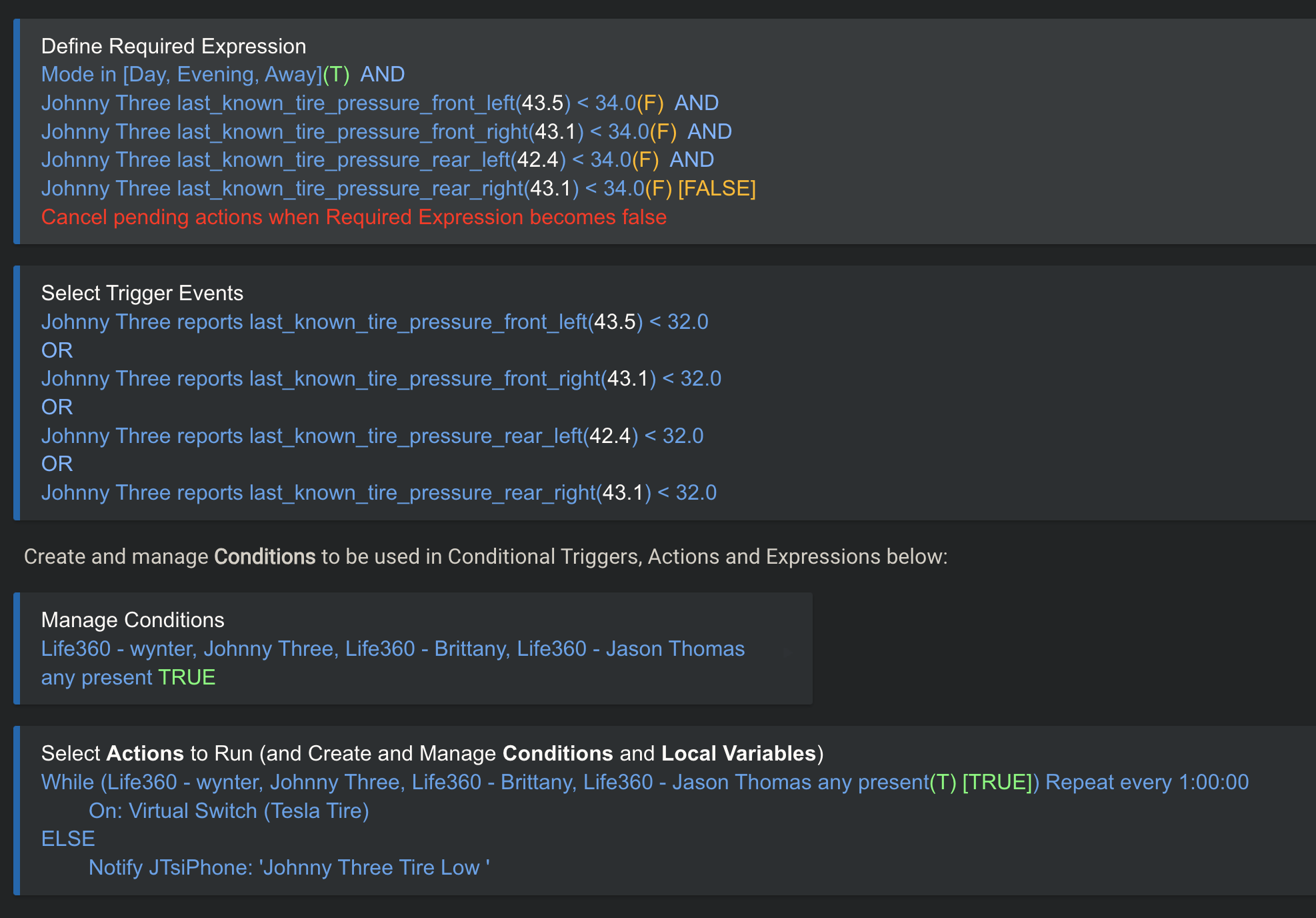

So, I have over thought this multiple times and decided to clean it up based on some data
@Sebastien and @Alan_F supplied in a Tesla Charge Rule. Thank you guys..
Originally I had this rule written to repeat until all Tires were above a specific value.. I now have the required expression cancelling actions if it becomes false.
I also used modes because I do not want notifications while in Sleep Mode.
Virtual switch is to notify, via notification Alexa Devices in home.
Thoughts?

I have a similar rule, and the issue you're going to have is that if all 4 tires are low (like due to a sudden temperature drop) the rule will fire multiple times, and it will likely happen so fast that even if you try to prevent that by adding a required condition that the private Boolean is true and set the private Boolean false on the first line it won't happen fast enough to prevent the multiple activation.
I'm using a contact debouncing app that was posted here to work around it. I'm typing this from my phone, but when I'm in front of a bigger screen and keyboard I'll post the details of how I set it up.

I try and keep tire pressure at 38-40.. The car is running 20s staggered and my wife seems to find every damn nail in the road from home to work.....SMH
I can see the issue with it triggering up to 4 times if a sudden cold spell comes overnight....
Maybe grouping the tires would be a work around.
@Alan_F

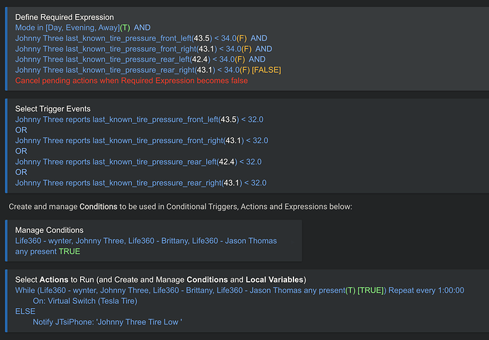

I changed it up a bit using XOR, maybe this will help with multiple triggers at same time.
As its written, and I undertand it,, Required Expression:
IF mode is Away, or Day, or Evening and one of the tires reports low, the required expression will become true and triggers will be applied.
IF the required expression becomes false, the remaining actions are cancelled, if applicable.
In order to group Custom Attributes, as i see it, I would need to create multiple virtual switches based on each tire pressure.

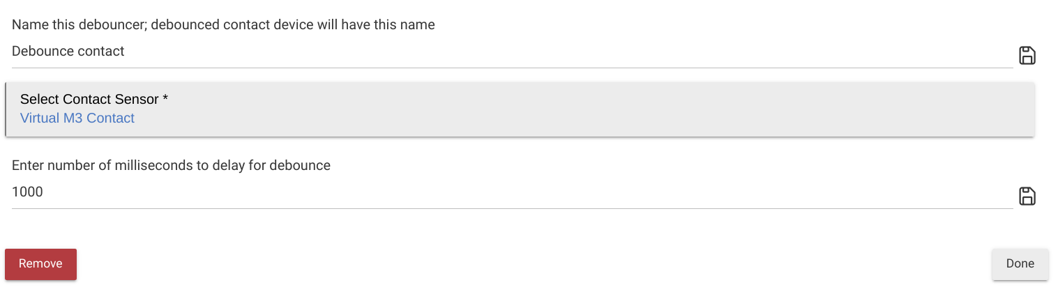

Install the Debounce Contact app from here: https://github.com/hubitat/HubitatPublic/blob/master/example-apps/debounceContact.groovy
On the left menu click Apps code:
At the top right of the screen click + New app:
Paste the code into the page and click save.
Step 3:
Add a debounced contact
On the menu click Apps:
At the top right click + Add user app:
Select Debounce Contact:
Name the debounced contact (mine is called "Debounced Model 3 TPMS" and select the virtual contact you created in step 1 as the sensor to be debounced.
I left the time at the default of 1000 ms.

Using the XOR wouldn't work for me, because even if it succeeded in debouncing the notifications, (and I'm not sure that it would... see below) then it would mean that I would only get one notification for the first value to drop below the limit. Since I include all 4 tire pressures in my notification, I want to make sure the rule only fires after all 4 values have been updated.
I'm also setting my threshold for 1.5 psi below optimal as I'm trying to get alerted when the tires need air due to weather changes even if they're not going flat. So I'm likely to get multiple tires going below threshold at the same time. The odds of two of your tires going below 32 at the same time are much lower, so you may not have a multiple trigger issue at all.
But setting that aside, I'm not sure the rule you set up will work. See this: Triggers and Required Expressions - #5 by bravenel
If I understand the linked post correctly, your rule will only fire when a second tire goes low. You need one tire (and ONLY one tire) to go low to make the required expression true. Only then would the second low tire actually fire the trigger.
Combine that with the possibility (especially if you were to go with higher thresholds) that all 4 conditions in the required expression might go from (F) to (T) within a few milliseconds when the car first starts to drive and I have no idea whether this would work at all in that scenario.
So for one tire going flat, your current rule won't notify you. For two going flat separated by a few seconds, it will notify you on the second one. For all 4 reporting low at the same time... your guess is as good as mine.

@Sebastien ---- I'm still pretty new at this, stoppable function eludes me, even though I have read up on it.
What is triggering the "stop"
@Alan_F - I See the issue with XOR.... Im moving it back to AND for now....
I will also work on your data for debounce tomorrow--- or later today rather. lol
I need to understand the concept before trying it... :slight_smile:
@jlv - With most BT sensor vehicles, they only update when the tires moves and wakes up the device... IF there is a sudden pressure change, increase or decrease, the sensor should wake up and register... Try adding air to a tire with out moving the car, the car should register after a minute or so.
In the example I provided, I enabled the stop but there is nothing in the rule that would cause it to stop. However, I could add a “Stop Repeating Actions” command somewhere in an if condition within the loop that would stop it from continuing. I could also add a “Cancel Rule Timers” in this or another rule that would point to this rule.
