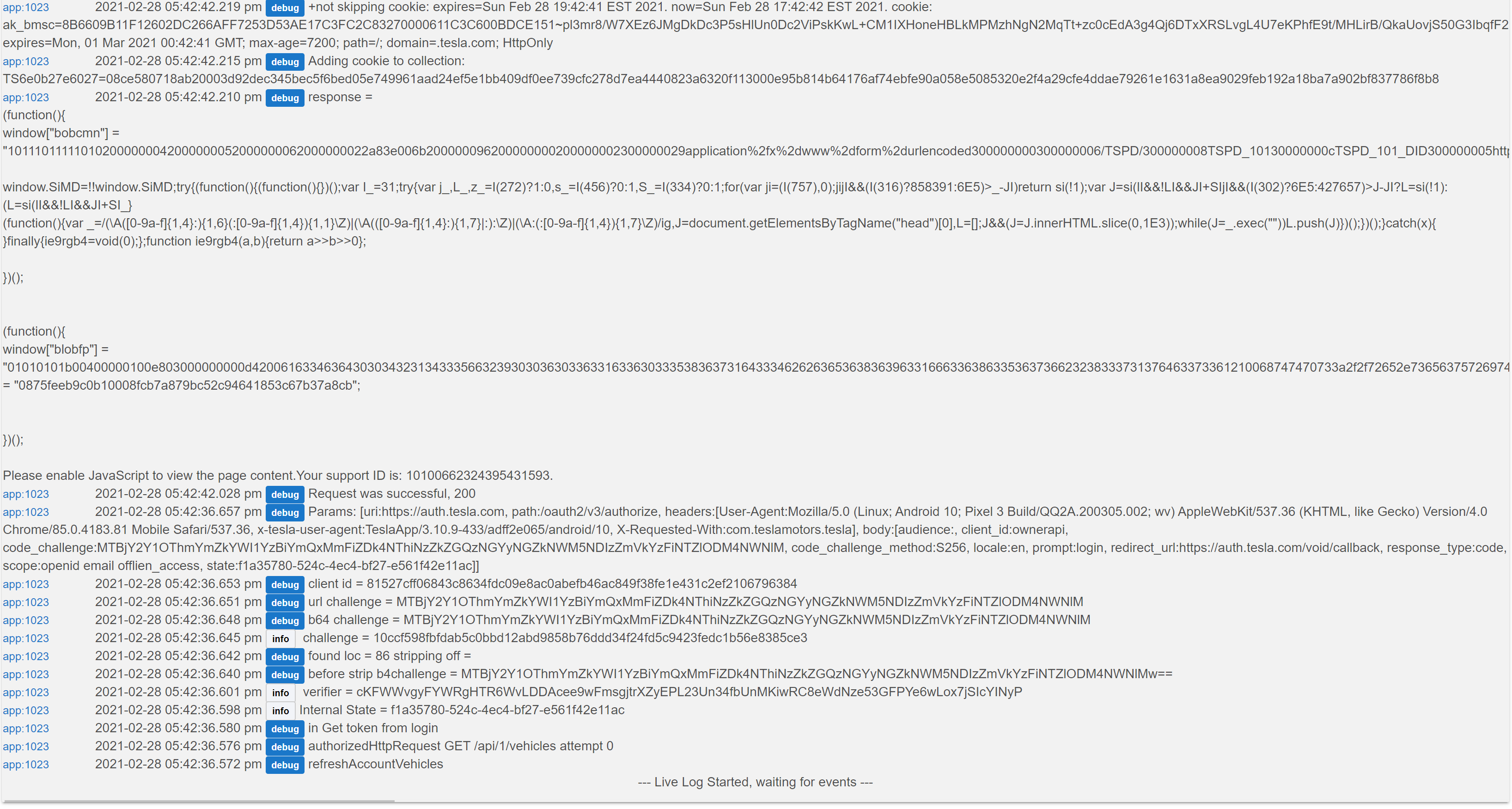

this is as far as i have gotten on the new oauth2. maybe someone else can look at it .. i have gotten the url encodeing and sha256 stuff working but the first call comes back with the wrong data.
ie
trying to follow the code here in python which does work.
but first page (see login) function is not coming back correctly'

dont hold your breath.. i dont think it is going to happen.. i kinda figured out why it is not working and why the python requires the chromedriver installed.. the new first login page returns a page that requires a javascript redirection and functions to display and decode the actual page .. This currently is impossible in hubitat. That is whay the page was coming back as a success with code 200 but did not display the correct response/info and has a message that javascript needs to be enabled.

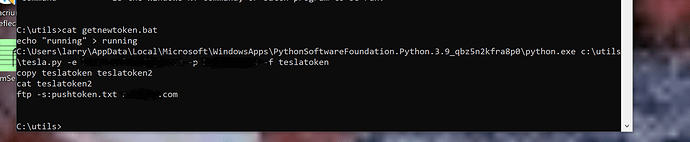

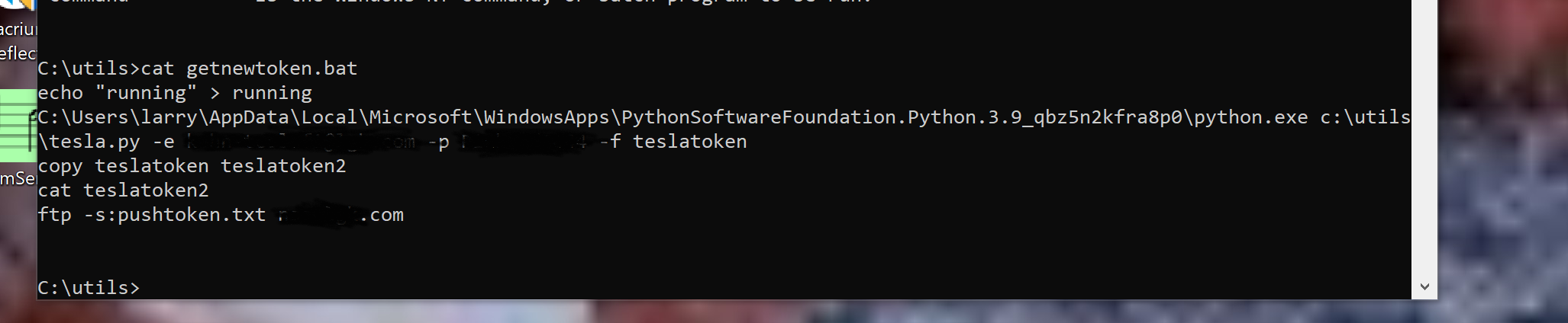

this is my command prompt script to generate the cookie.. intererstingly it would not run as a windows scheduled job with task scheduler.. it had to get a 3rd party scheduler to get it to run correctly.

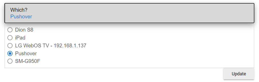

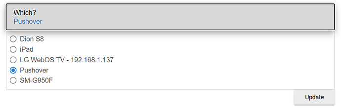

ya i should add a better explanation. it is a notification device to send a couple of new notifications when the cookie update is attempted and if it suceeds or fails.
I just added the description and updated the git hub.

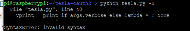

i get this error, i have installed a fresh raspberry pi with python 3 and chromium-chromedriver
i am not familiar with python...
you need to put the requirements file on there and run the pip command to isntall them..
also verify what version of python is running.. i had same issue on my qnap it was running an older version.. and gave up trying to get the newer working correctly and hence put it on windows.
i believe it is python -V
