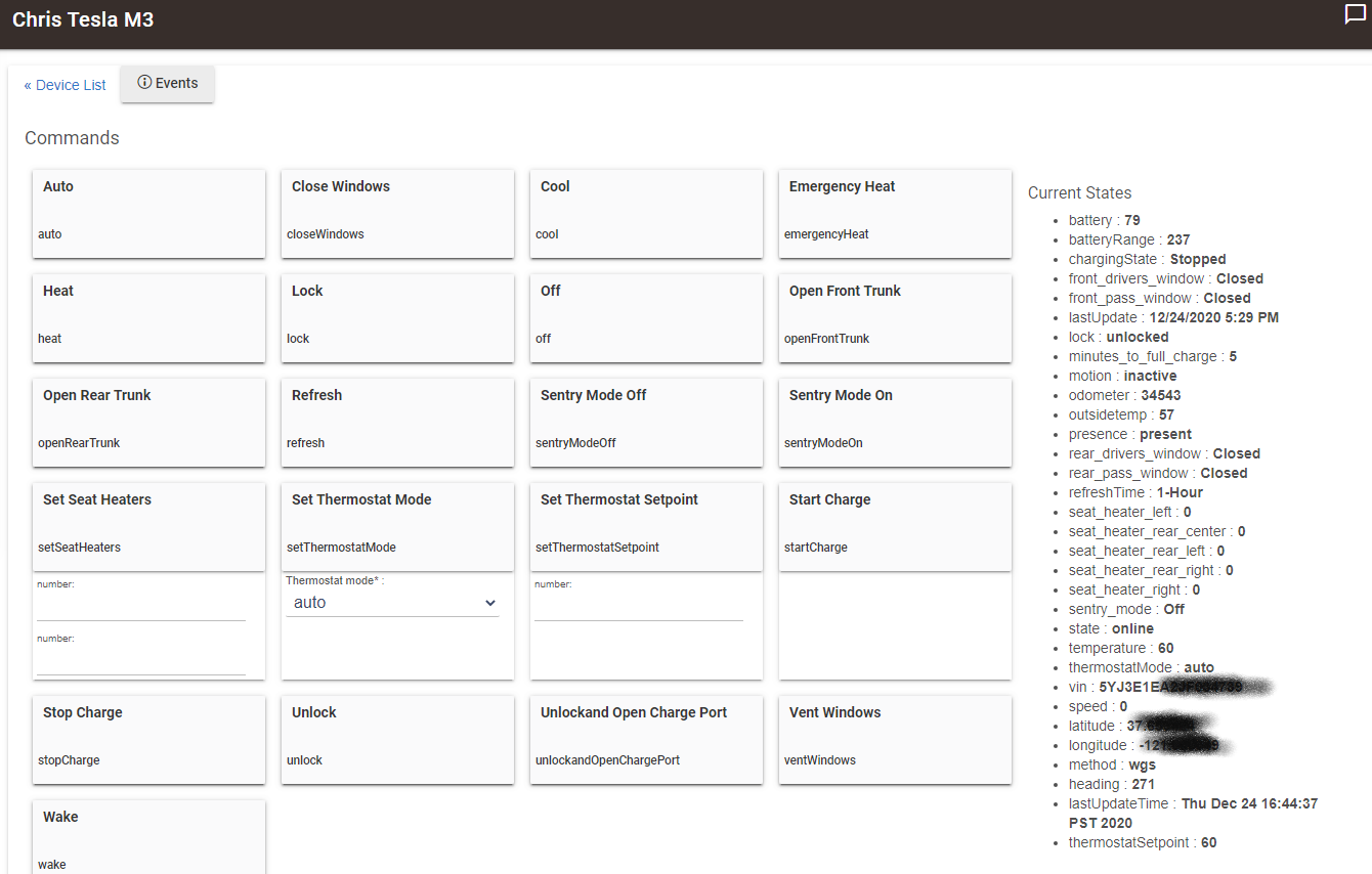

@kahn-hubitat I had the day off work so added several more attributes and commands to the App & Driver (Sentry Mode, Seat Heaters, Vent) Basically key commands that I can use to write Hubitat Rule Engines e.g. If car is at home and HSM set to Armed than turn Sentry Mode On. If inside temp of car is > 100 than Vent windows, etc. I've also got this integrated with my Amazon Echo so I can now say "Alexa prepare car for departure" and climate is activated and once temp is reached Alexa announces "Your Tesla is at desired temperature and ready for departure"
The updated App and drivers are available at:
Hopefully you post this code to your GitHub so others can benefit.
It has been years since I wrote any code so this was a fun project to leverage off the original work done by @trentfoley and you.
Here is what what people should see after installing this version of the app/driver
My next goal would be to update the Seat Heater commands to be a drop down menu so you don't have to remember what number each seat is.

i integrated your code for windows, sentry etc status
Thanks.
I also added a new option in the driver to select either F or C and display the current temp and setpoint based on that value.. Also when setting the temp i use that value to decide on conversion.
I did not copy verbatim but integrated changes and added the new temp scale changes. So let me know if you see any issues.
Also converted temp to integer before setting the setpoint.
change in the github. and also via hubitat package manager..
slight change .. add unit to sendevent for temp so it displays on dashboard either F or C
Thanks everything is working great with the new version and I'm sure the Tesla users outside the U.S. appreciate the option to display F or C. Next week I might find time to create a drop down menu list for the seat heaters. The only other enhancement I can think of is updating the driver to take full advantage of the Thermostat Dashboard Template to avoid having to create a virtual Thermostat driver and rule to fully control the Tesla climate and get proper status being returned to Dashboard. Again, low priority for me as I've got virtual drivers and rules create to get around all this.
