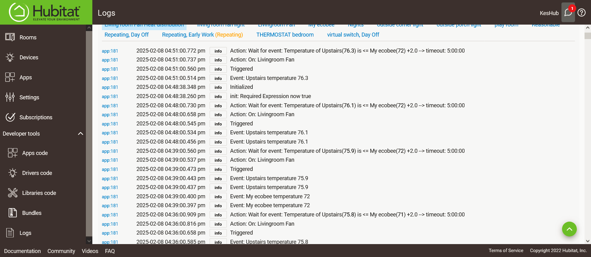

The fan used to start right up whenever I had a fire and the temperature difference got large enough from the ceiling and floor. But now it will only start when I manually run the rule.

Got it, thank you, that was the only log on the switch. Seems like the rule log is triggering a lot but the switch isn't turning on.
For starters, I would write a way to prevent the rule from triggering every three minutes when the temperature still reports a delta of 3.5 degrees and is still in a wait for timeout status. You likely have an instance of the rule running for each of those trigger events in your log. Use private boolean is false in the required expression in addition to to the date constraints. Have the first step of the rule turn the private boolean true, and the last step should be private boolean false.
Secondly, it would not hurt to cancel rule timers for the rule (second action) just in case you have an instance already running.
Maybe not likely, but possible you are still on a wait from when you manually ran actions to test it out.
Also, since it is showing "turned on" in the logs, have you verified that you can turn the fan on from the device page in hubitat? (maybe asked an answered in that it worked when you ran it manually. But, it wouldn't hurt to check and make sure the device is actually receiving commands and acting on them)
