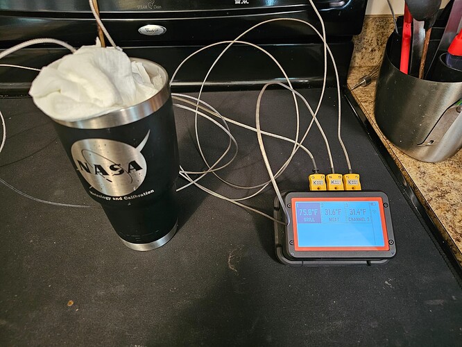

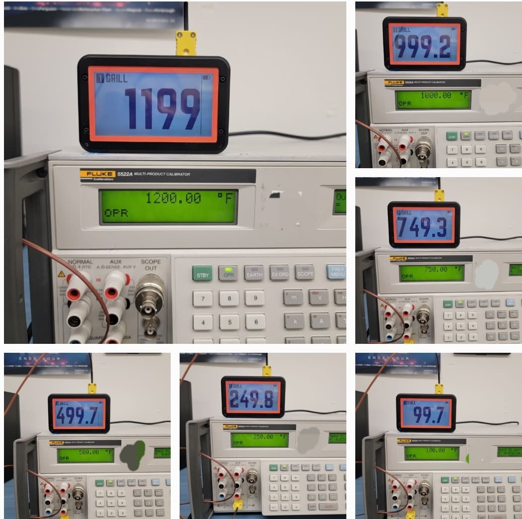

This is me checking my grill thermometer (had to show the MFR that their probe was bad so that they would send me a replacement: Note the ~75 degree probe on the display). Ice bath using DI water and crushed ice made with DI water per ASTM E563 (tap can cause up to .5 degree error).

Wow!...I really like the official NASA insulated calibration cup and the reference to ASTM E563.... I did have to look up the word "Metrology" :grinning:

As to the cup, any insulated cup or thermos will work as long as it is clean. For holding 0.01 kelvin, you want a dewar flask per the ASTM though. Also of note, despite the seeming stability of an icebath, it isn't a reference in and of itself. It actually requires a calibrated thermometer, usually a high end PRT, in order to be official. Even with the best of DI water, the temperature will almost always be slightly off. (Most labs use triple point of water cells when it matters)
In any case, the original point was that the OP did not state how accurate he wanted his baseline. You would need to know that to know the best way to proceed. And, depending on the want, it might not even be possible given these are cheap devices. (In the measurement world, accuracy costs $$$..... way more than people would pay for these types of devices). You can convince yourself that they are accurate at a given temperature. But, once you go higher or lower than the temp you checked at, results can and will vary.... sometimes drastically.

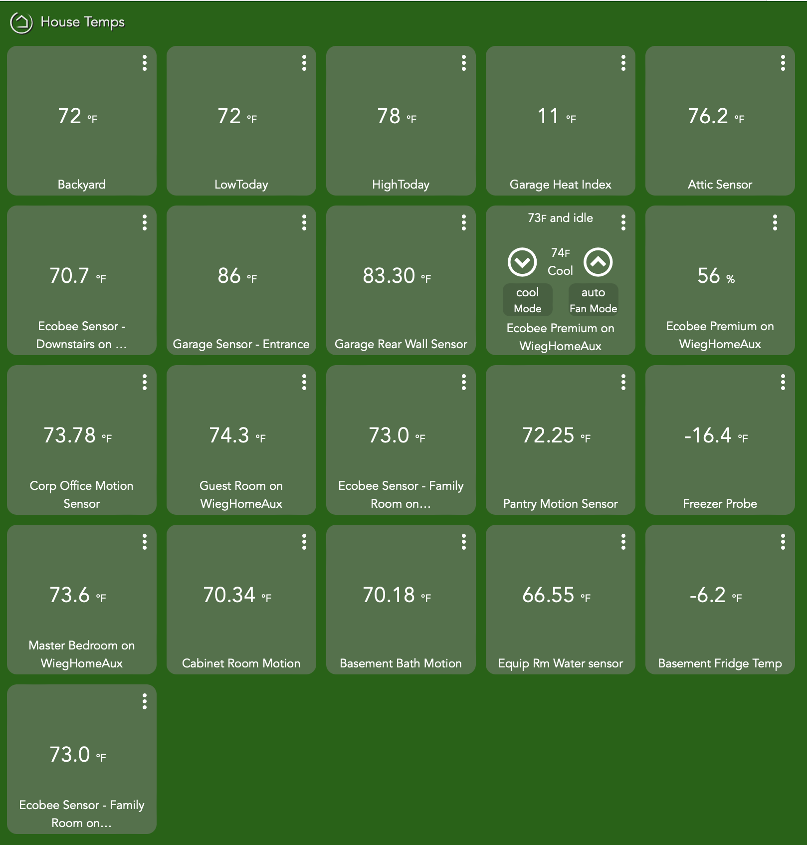

We had this problem with "what's the temperature outside." Accuweather says one thing, Apple Weather another, Weatherbug etc. So, I bought a Ecowitt weather station, put it in our backyard and we just go with that as the "true outdoor temperature" at our house. Inside I have so many devices that have the "inside temperature" that I have no idea what the temperature is. :smile:
Of course the issue is, the temperature anywhere (inside, outside, down the road) is never the same. It varies inside with heating or A/C not being in perfect balance. The sun hitting one room and not the other. In my case the upper floors are usually warmer than the lower floors, until the sun goes down then it is the opposite.
