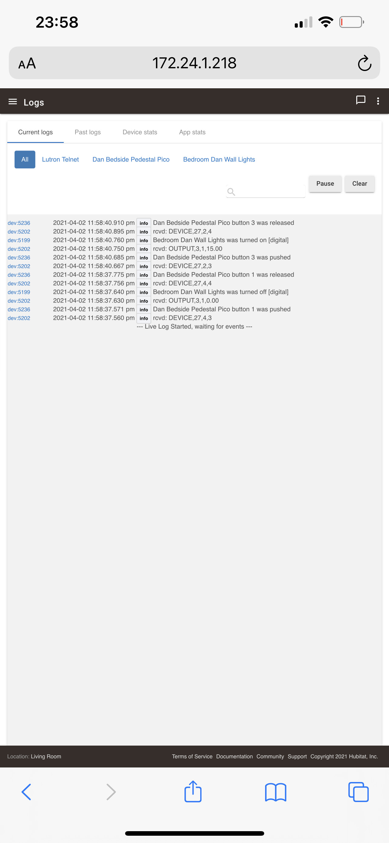

There is a known Lutron issue with channel occupancy blocking commands from Pico via hub to Lutron. On RA2 there is a 1 second lockout. On Caséta it can be a number of seconds. How long are you seeing?
One fix is to use some non Lutron button device instead of a Pico. Another fix is to invest in a RA2 main repeater that can put your Picos on a different frequency than your RA2 Select system.
It probably is around one second and my perception was that it was worse if there were events in quick succession eg an off then on, the on would be slightly delayed….
That's better than Caséta for sure.

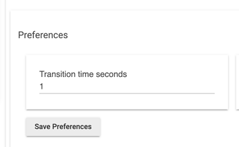

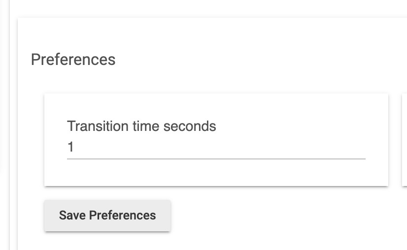

Do you know if the ramp up / down speed of a dimmer can be adjusted through the telnet interface ? You don’t have any control over this on the ra2 select app, but this adds to the perception of a “delay” too..
I just ran a quick test on my Caseta system, using Basic Rules to link a Pico to a Caseta Dimmer. The delay is exactly one second.
You can set it to zero on the device page:
That’s great! That certainly helps with reducing the perception of a delay! I had missed that!

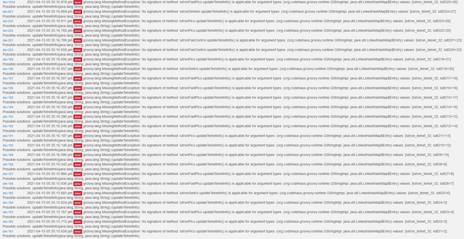

@bravenel I just clicked the Telnet Direct option and clicked done in Lutron Integration app and got a bunch of errors for each of my Picos. Everything still works but I repeated steps and got same errors.
And errors go away if you disable it?
