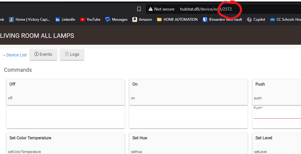

http://192.168.1.211/apps/api/1655/devices/[Device ID]/[Command]/[Secondary value]?access_token=xxxxxxxx-xxxx-xxxx-xxxx-xxxxxxxxxxxx. Next, open the device you want to control in your browser and look at the URL to get the device number.

When the Action Edit screen opens, scroll down to the URL line and past the Command URL from Maker API. Replace "[Device ID]" with the device number from above.

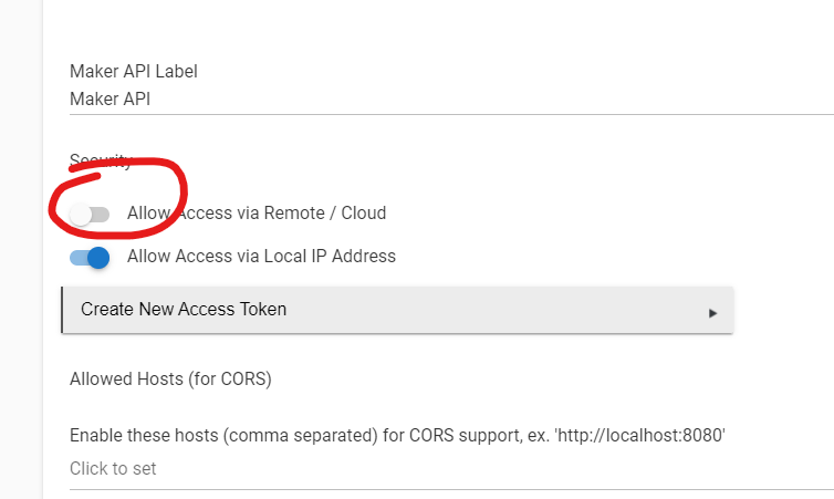

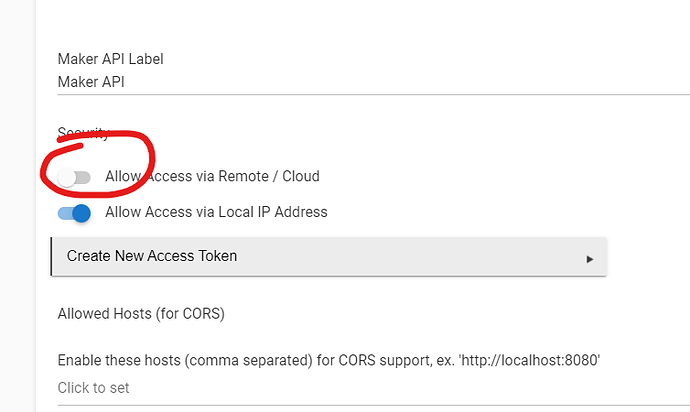

If you might need this for when your device is not on your home network, turn on Allow Cloud Access for Maker API and use the URL for Cloud Access instead.
