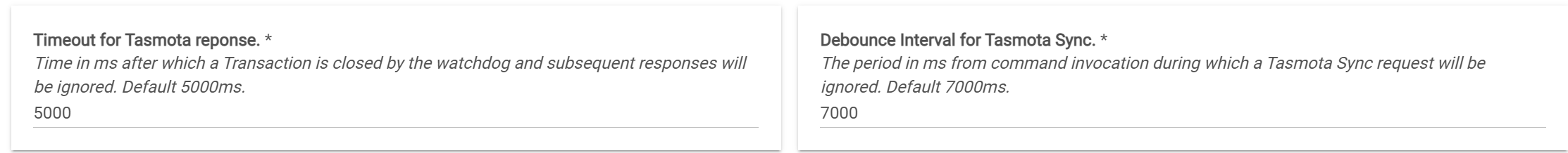

If you have read the documentation then you will understand how this can arise and which parameters can be adjusted to tune it for your use.

No Data is a response you will get when either using power monitoring or the universal sensor driver and the STATUSSNS (STATUS 8) response is empty.
Understand these and you will understand the limitations and decide whether your environment can live within them or not.
