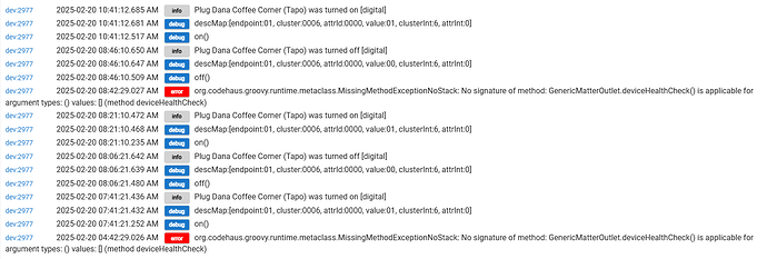

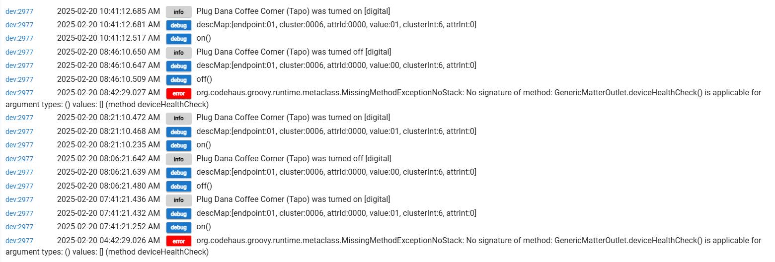

Seeing errors from Matter Tapo plug (P125M) overnight when not using as well as this AM while using. I have four of these, only one is throwing errors.
4:42AM error I am def not up/using it. 8:42AM error I am using the plug.
Using HE built-in Generic Matter Plug driver (selected by HE during join).
Me issue, or driver, or ?
deviceHealthCheck isn't a method that's used in any of our built in drivers and is left over from a community driver, go to live logs, then scheduled jobs, find that method in the list associated with that specific device and then delete it.
Cool, thanks for the pointer, didn't notice that.
