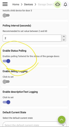

I found that in order for it to correctly report status, you need to "enable status polling" in the parent device. Once you do that, it works properly.
Will do let you know when it’s working

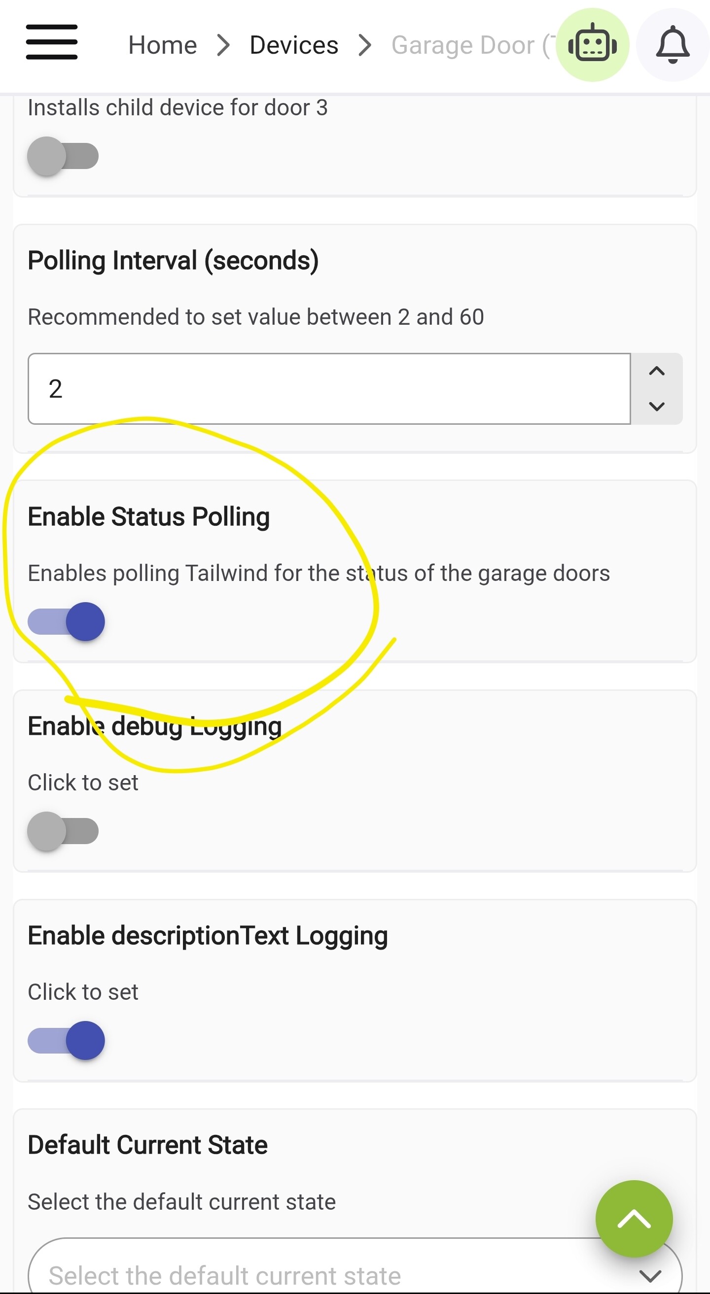

See attached screen grab. Parent device preference make sure this is switched on.

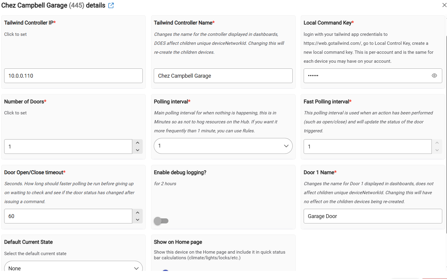

Thank you for the reply. I've been looking for this option in my parent device and I can't find it! I'm at a loss as to why this option isn't there for me. I'm using the drivers that are linked from the Tailwind site. It's clear looking at your screenshot that I have a different driver than you. What is the source of your driver @bobbo?
I use this one.
Great. Will give it a try tomorrow and report back. Thanks for pointing me in this direction.
