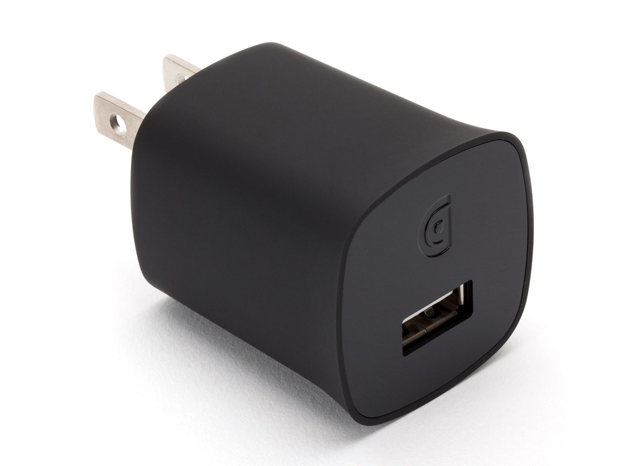

Sometimes a bad power supply will degrade the hub enough that it fails to load properly, may want to try swapping out the power block for a known good one. Outside of that: @support_team

He means the block that the USB end of the power cord plugs Into. Do you have an extra phone charger available you can use to at least and see if the adapter is the issue?
For reference something like this

Any Known good " Power Brick " 2amp is better ..
( might need a Magnifying glass to see what the amperage is )
An old power brick from Samsung phone or Other type of phone might work just fine..
Least likely part of the chain to have problems, but I also always change the USB cable as well when troubleshooting stuff like this, just to be sure.
Oh, cool, wasn't comfortable doing that, but ok, I'd bet with all the plugs I have, I'm bound to have that type of USB end and I have several flavors of power blocks. Learn something new every day, power block eh, sweet. I'm headed to try, back in a bit, bet to order a C8, ho hum, oh and a UPS for sure, what an expensive lesson we had here.
