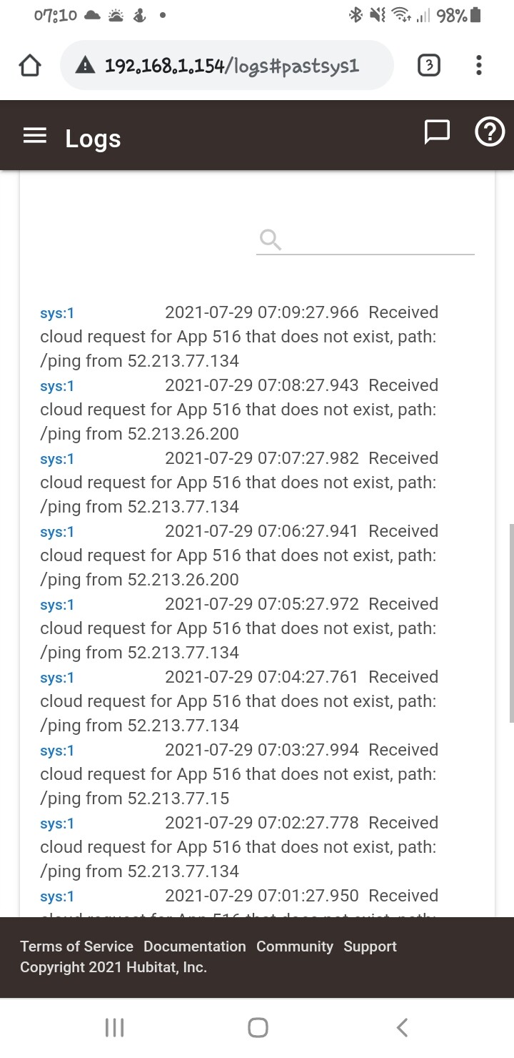

Sys:1 app 516 error
Any one know what this is and how to stop it???
Did you setup a Hubitat integration with a cloud-connected device, and then delete the app in Hubitat?
That’s essentially what that error log message is saying.
To add to what @marktheknife indicated, I think this is from a HubConnect integration with SmartThings.
To add to what @marktheknife & @aaiyar said, this message is for informational purposes. It simply says that an external service is trying to reach an app on your hub that no longer exists. Removing the hub's IP address from the respective integration is the only way to stop the messages to hit your hub. Common integration seen on support tickets are HubConnect, Life360, but it could be anything that you might have set up to communicate to the hub via local network.
You’re right. It’s not an error, it’s a message in the log. Corrected my post above :sunglasses:.
*updated - not to imply your message is coming from smartthings but one idea where to look *
I struggled with this log message and had a heck of a time determining where it came from - Ultimately I found it (accidentally) as being the Login of the smartthings Dev account. Recall there was TWO logins on Smartthings - the initial account then later they moved the api.northwest blah blah site to authenticate via Samsung account. Check both!
There's a link (cloud or local) to an app that no longer exists on the hub. These requests come from the outside, the hub merely registers it and complains.
