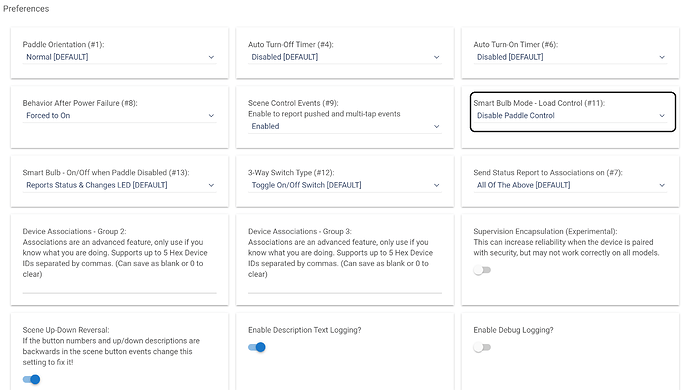

I was asked the other day but want to confirm, how do you set smart bulb mode on the zooz switch? (or innovelli if you know as well)
Smart Bulb mode :smile:
edit: Also use Scene Control to activate button events.

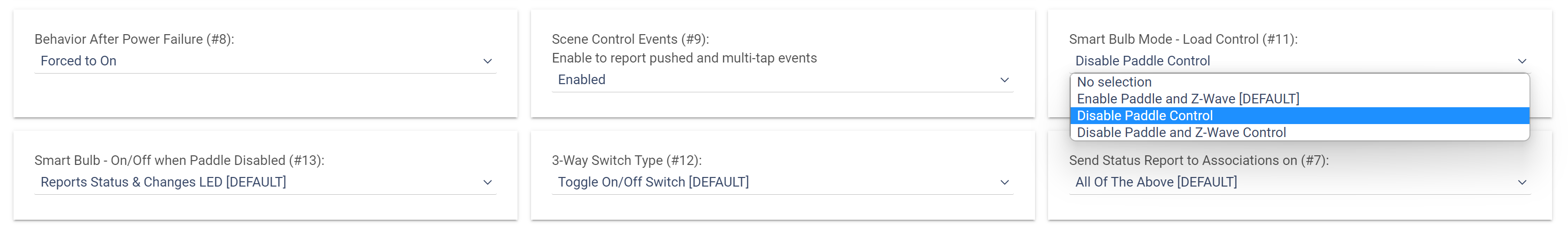

It's a parameter setting for Zooz, but the language Zooz uses to describe the options kinda makes my head explode... Perhaps I'm just dense, but I struggle with their descriptions -- I can't say these are the exact same for all the Zooz SBM devices, but the parameter choices are ala this:
A) Enable local / physical control (from the button), enable Z-Wave control -- this is the default setting -- this is for when you have an actual lighting load connected to the switch.
B) Disable local / physical control (from the button), disable Z-Wave control -- As best as I can tell, you use this if you have no actual lighting load and you don't need z-wave direct association. But you can still use the switch to control scenes etc. This is the parameter I use for my Z71 that I use as a simple scene controller in our living room and it works great.
C) Disable local / physical control (from the button), enable Z-Wave control -- I think this is used when you have no actual lighting load, but still want to use z-wave for direct association. I'm not sure about that last part, but it's the only explanation that makes sense to me WRT option B.
@agnes.zooz -- am I close in my understanding? Thanks!
Yeah @jtp10181 's terrific advanced drivers which I use expose them like this..
What about for innovelli?
Points A and B are correct. Associations are actually their own separate thing and the association commands are sent regardless of this setting.
Point C refers to a scenario where you don't want anyone controlling the lights from the physical switch but you DO want to control the connected load via Z-Wave (automations, voice, or on demand from the app). An example would be an outdoor light switch located next to another switch used to turn a light on inside of that room. Sometimes you forget which is which and you accidentally turn the outdoor light switch on without realizing it and the outdoor light is now on throughout the day for no reason. If you disable local control on that switch, it won't turn that light on if you (or someone else) tap it by mistake. You can then program scene control on the switch instead to turn the light on and off but only after dark. In other words, this setting accommodates some more sophisticated automation scenarios where you want to limit control of the connected light from the physical switch in favor of controlling the light mostly via Z-Wave (automations, schedules, etc). I hope that explains it better but let me know if you think we could make changes to the documentation, we're always trying to improve it!
It still registers the button push though but essentially disables triggering of the relay correct?
yes thats right..
Good stuff - thanks Agnes! The various scenarios are tough to boil down in just a few succinct words, so that additional color is helpful.
For me, it was hard not to get derailed by the "...disable ZW control" part of the descriptions even though you guys foot-stomp elsewhere that scene control etc will still be available regardless.
At first blush, "disable z-wave control" sounds pretty ominous, but I knew it was (of course) something other than literally disabling the switch's z-wave altogether.
Thanks again!
