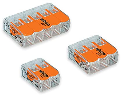

If you are going to be replacing a bunch of switches and wiring into neutrals, I HIGHLY recommend getting some Wago Connectors 1st.
https://www.google.com/url?sa=t&source=web&rct=j&url=https://www.amazon.com/wago-connectors/s%3Fk%3Dwago%2Bconnectors&ved=2ahUKEwiGmqOxptPvAhXkx1kKHUMYAIkQFjABegQIAxAC&usg=AOvVaw1M2a-QXR68rkSg6Lm-mNH_&cshid=1616945261600
They are so much better that twist nuts and I don't see them mentioned here very often.
