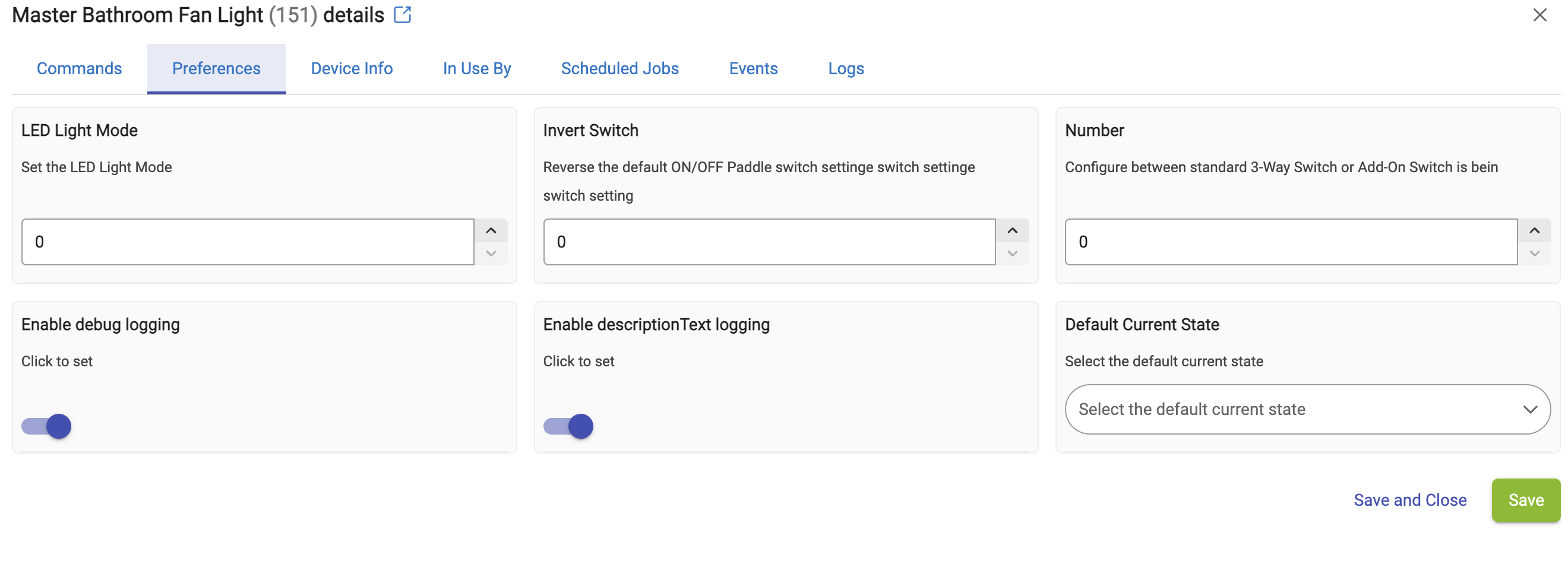

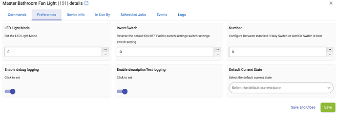

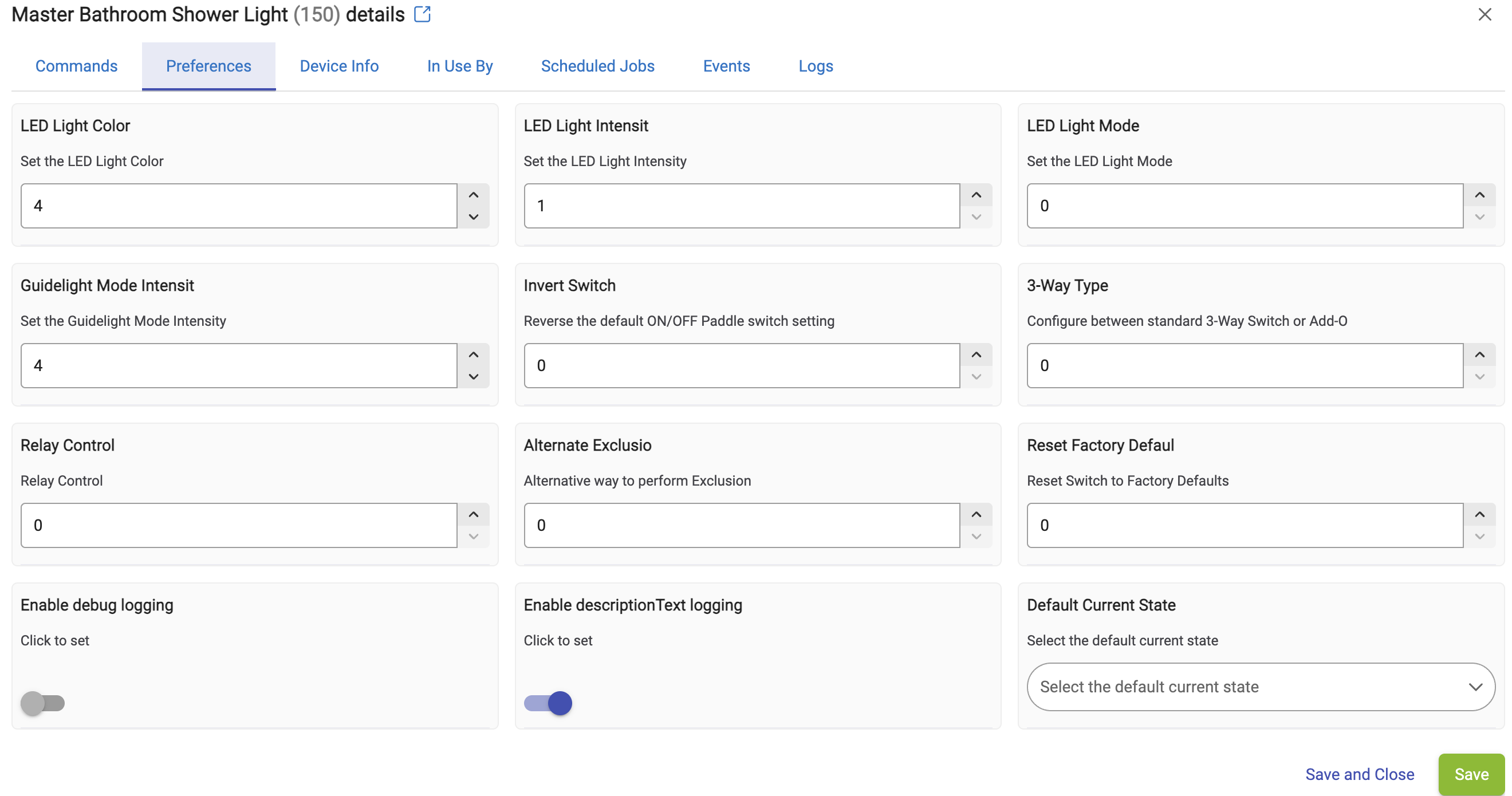

This is the first switch. It has 6 preferences.

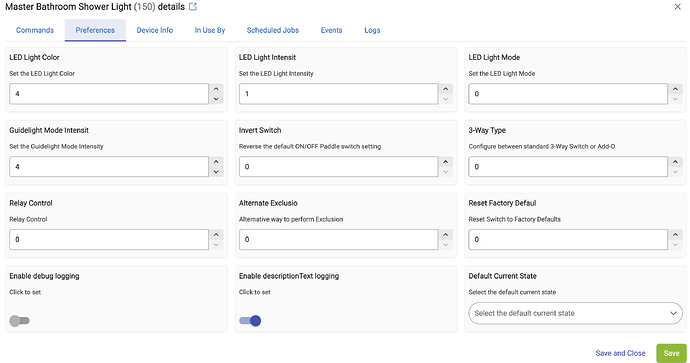

This is the second switch. It has 12 preferences.
As you can see, the details pages are pretty much identical but the preference page is not.

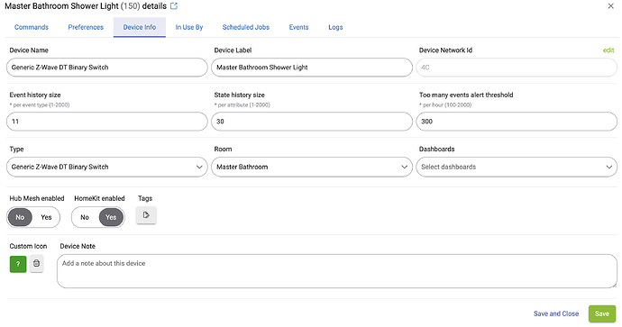

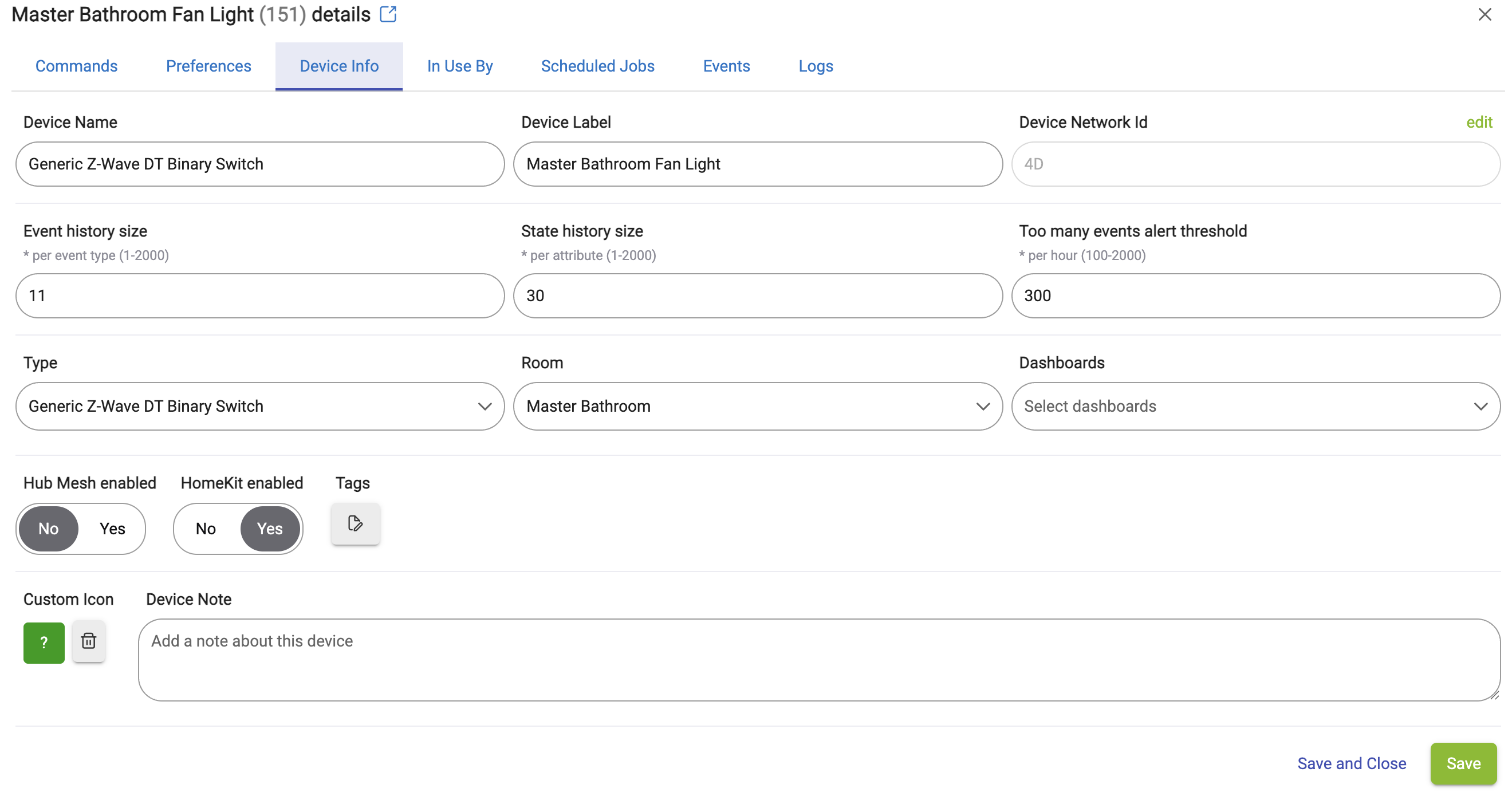

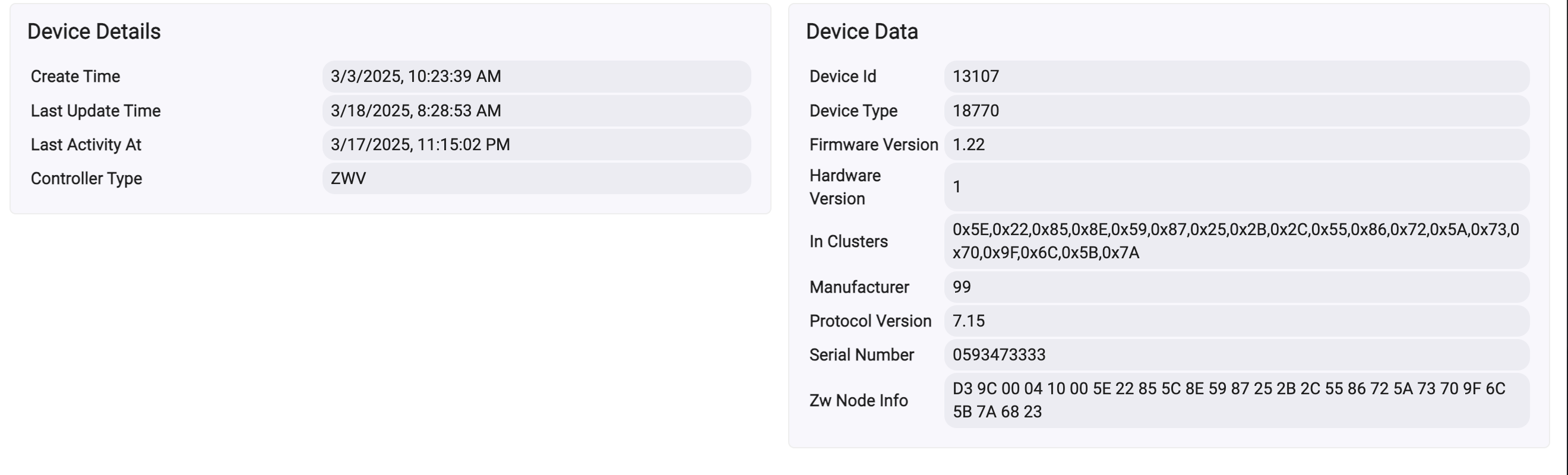

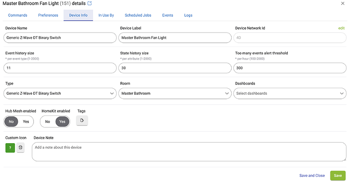

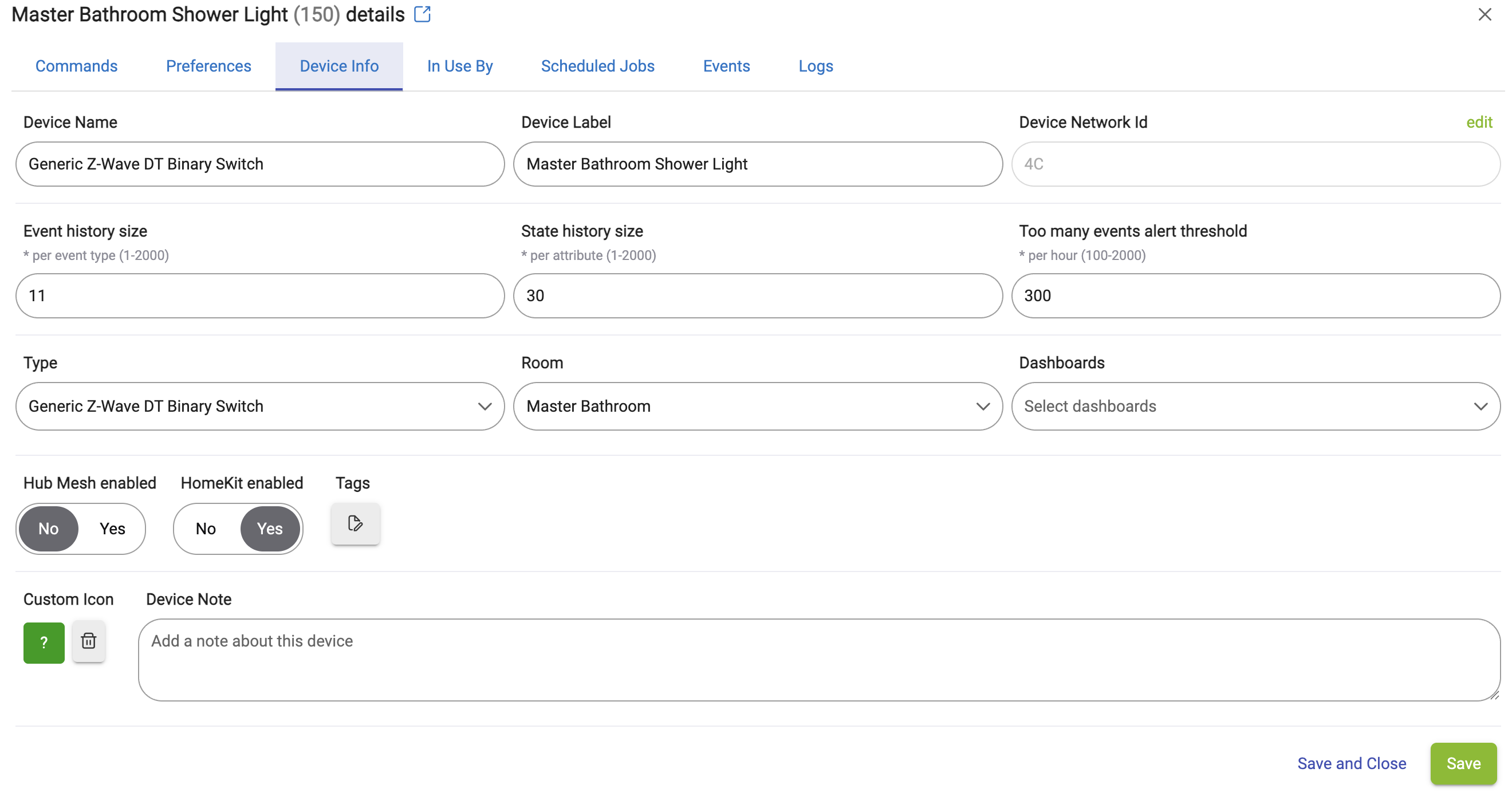

These are the device details from both switches as you requested.
They look to be exactly the same.
I don't see any differences there, either. There's still this question:

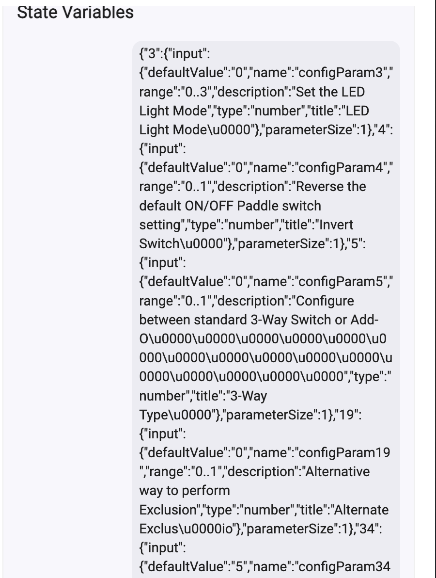

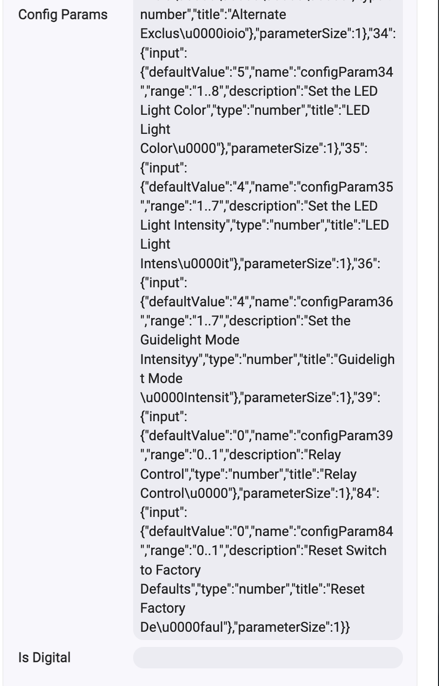

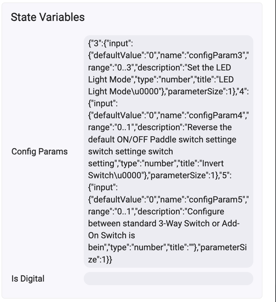

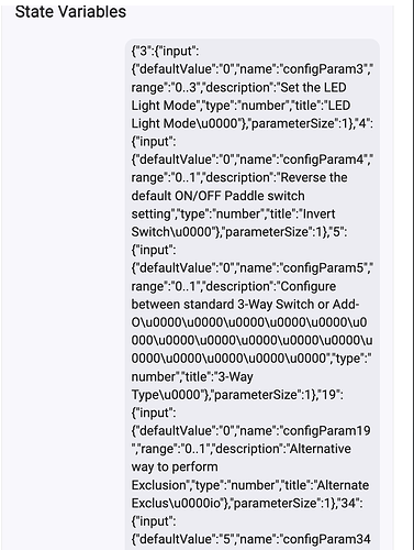

I did notice this.

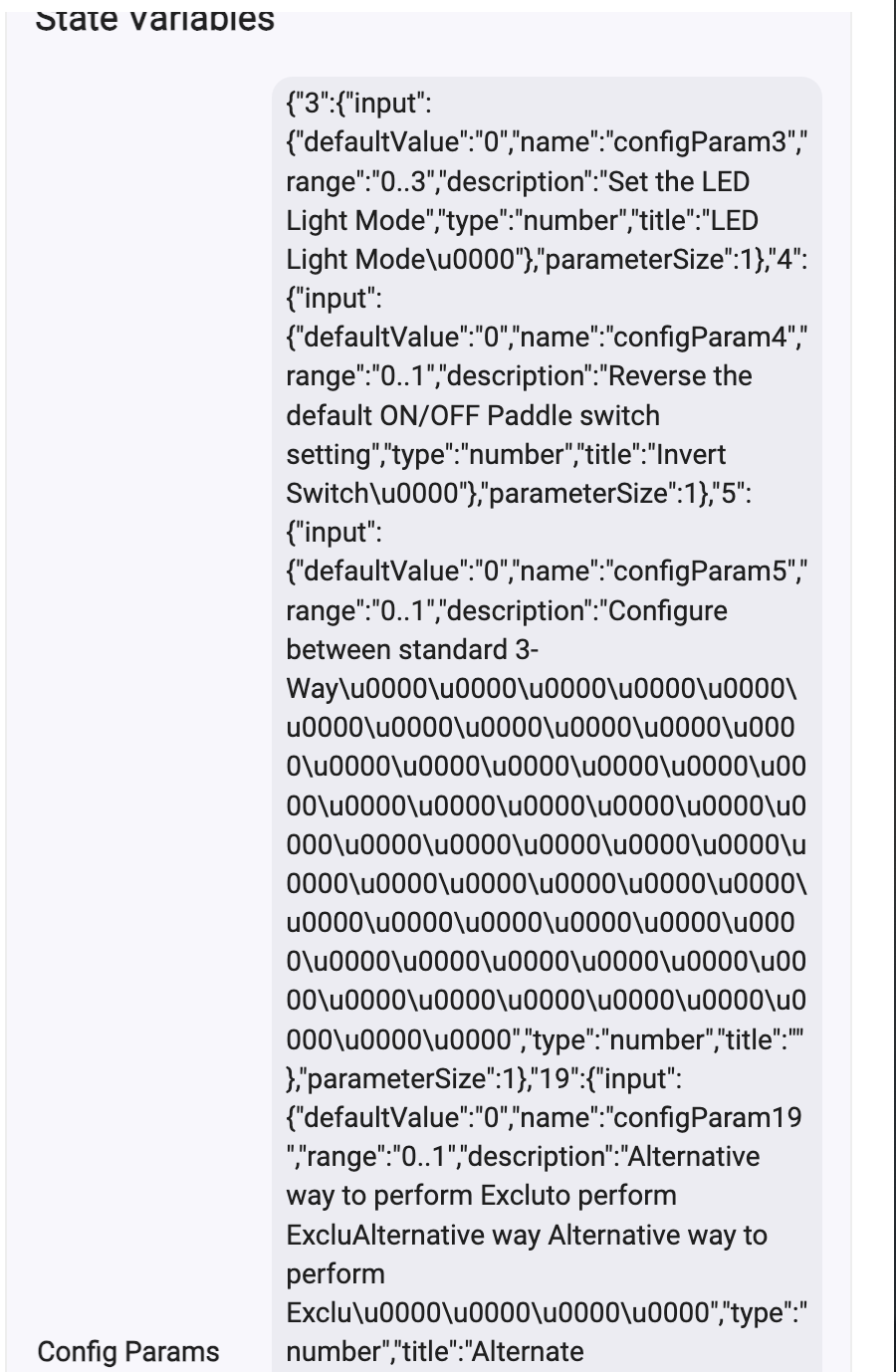

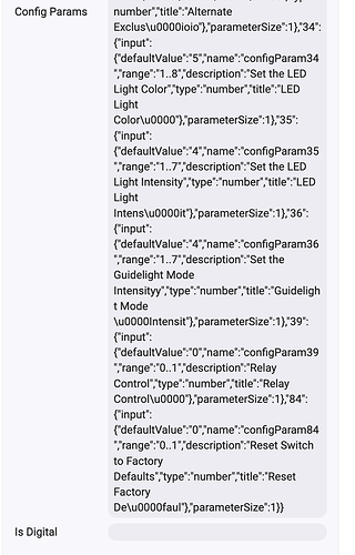

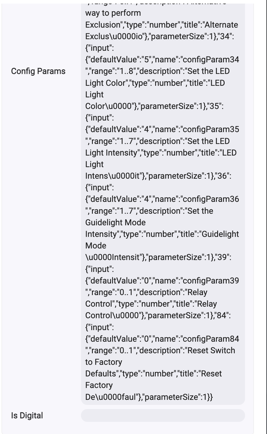

The one with the 6 preferences is 19 lines. The one with 12 preferences is so long I couldn't get it in one screenshot.
Pressing Configure apparently fixed the problem. I now have all preferences on the switch.
I will investigate this further. I was sure I already did that. It now looks like this.
We will see if the preferences change as expected.
The "DT" Z-Wave drivers read information from the device (notably, the configuration parameters that display preferences on this page), which a "Configure" forces. This happens on inclusion as well, so you don't normally need to do it manually, but it's possible your devices either didn't get the message or didn't respond for some reason.
