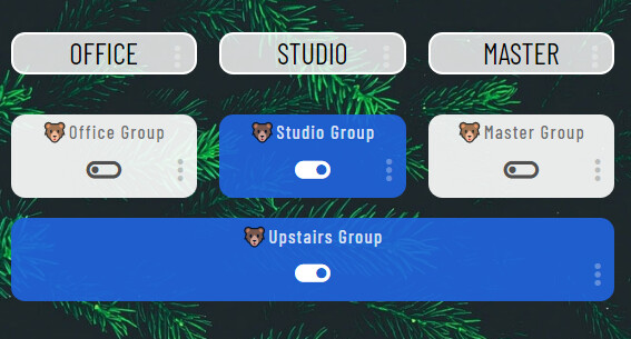

I agree with @wayne.pirtle. Groups are great this application. I have multiple groups and I have groups within groups. I have all of my groups setup with “Use group device to indicate if any members are on” That way on the dashboard the group will indicate if any switch or light is on. I have higher level groups that only control other groups of groups. I attached a snip of one of my dashboards. This shows the three groups (Office, Studio and Master). The studio group is blue because lights are on in that group. The upstairs group only has entries for the three groups, it’s blue because the studio group is on. The links above are links to the dashboards for the individual rooms. I don’t use the groups often to turn things on but use them when shutting things off. When my “we’re sleeping rule” runs, it just needs to turn off the upstairs group and it turns off the Office, Studio and Master groups. I also use them to manually turn off rooms or floors from the dashboard.
Dashboard group snip
