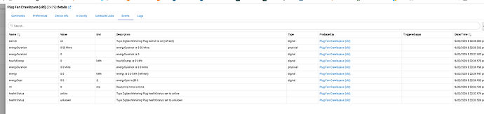

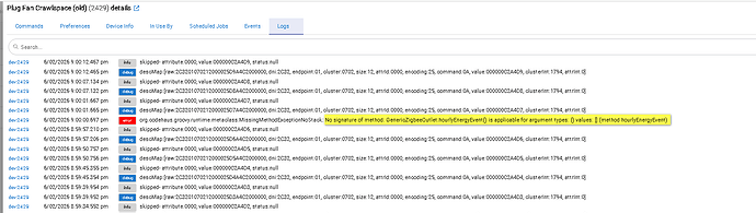

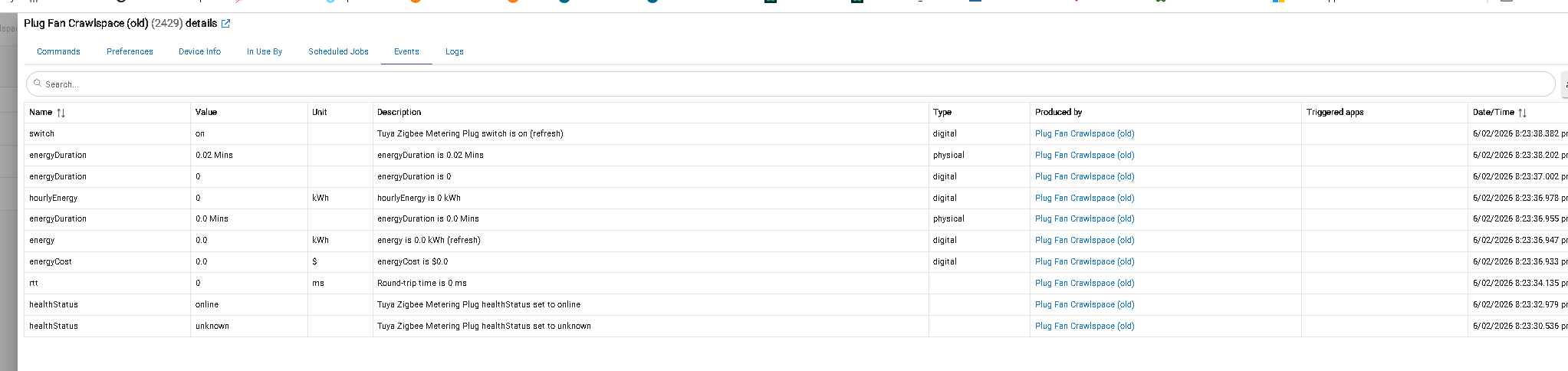

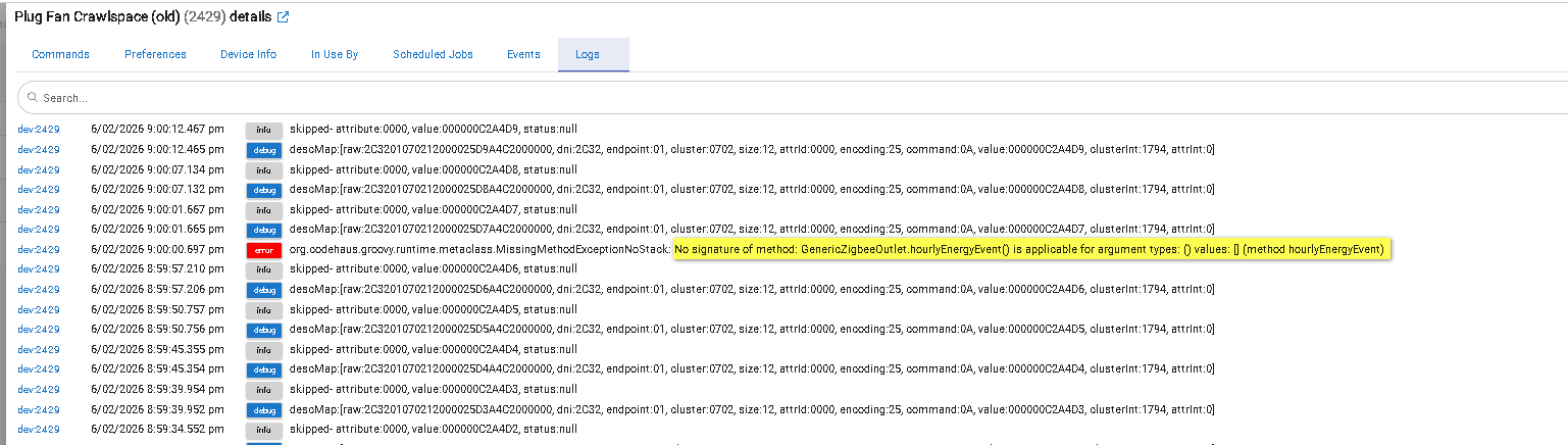

I think there is an issue with swap devices. When I look at the logs for the old device(sengled E1C-NB7 which uses generic outlet driver), it has the driver name of the new device (Tuya metering plug) in its logs.

Swap Device works by essentially swapping the device IDs at the database level (for supported devices). Logs are also identified by device ID. Therefore, when you swap an "old" and "new" device, you will indeed see logs from a previous life ... or at least I don't think it digs into the log files (which are not part of the database) to retroactively change anything. I think that's all you're seeing in the first screenshots, but correct me if I'm missing something.
