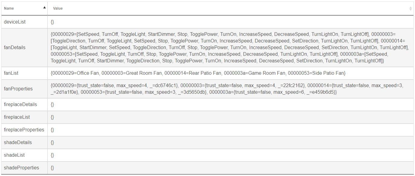

So it's not that HE doesn't know, it's that I haven't built that support. BOND has two methods of dimming depending on the device, one where you can just set a dimmer level and one where you hold the button. I didn't build anything to support the hold method. Let's confirm this is the problem, could you click the little gear next to the BOND Home integration app and paste the following:

Here you go. I can help you test. I have 3 fans with dimming capabilities.

Sounds good, and yes my theory is correct. You have the StartDimmer command listed there instead of the SetBrightness

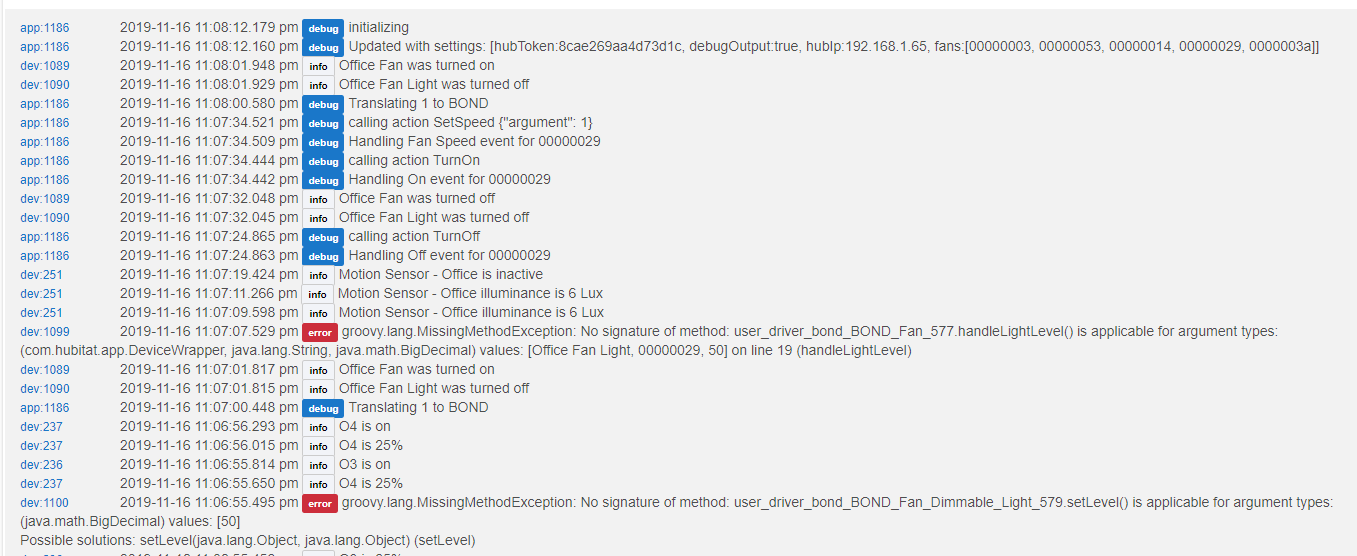

Perfect timing, I decided to take a stab before bed. I put it in a separate branch for now GitHub - dcmeglio/hubitat-bond at timed-dimmers you need the new app as well as the new dimmable light. You'll probably need to mess with the setting for the timer in the light a bit. Let me know if you hit any issues but I probably won't be able to spend much time on it until tomorrow evening.
You will need to delete the fan from HE and readd it so that it correctly makes it use the dimmable driver.
Edit: If you could make sure the debug logging is turned on for the first few days too that'd be great. If something does go wrong the logs will be helpful.
Went ahead and did clean install of your branch on my second HE. Light doesn't seem to work at all. Not sure where to even turn it on in the device. See log file
